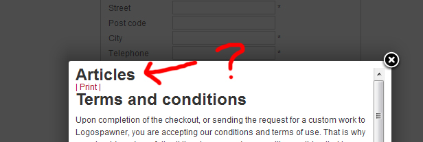

Hello
Why is the word "articles" displayed on my terms of use title?
  • Posts: 83603
  • Thank you received: 13533
13 years 10 months ago #18612
Isn't that the title of your article ? Or its category/section ?
  • Posts: 44
13 years 10 months ago #18618
None of those. It's nor the name of the article or the name of the category.
I don't know where it came from...

I don't know either. Could you give a link to your shop so that we can see that ?
  • Posts: 44
13 years 10 months ago #18626
www.logospawner.com
There is a module on the top left colunm with a sample of a product you can add to cart. Jusk click checkout on the cart module, and at the bottom of the checkout page you will see the terms and conditions.
Thanks.
  • Posts: 83603
13 years 10 months ago #18645
It's because joomla 1.6 suppose that the heading is deactivated by default.
You need to edit the file terms of the view checkout via the menu Display->Views and change the line:
$text = '<a href="'.JRoute::_('index.php?option=com_content&view=article&id='.$terms_article.'&tmpl=component').'" class="modal" rel="{handler: \'iframe\', size: {x: 450, y: 480}}" target="_blank">'.$text.'</a>';
to include an Itemid of one of your article menu there. So for example, if you had a menu 48 with an article, you would have:
$text = '<a href="'.JRoute::_('index.php?option=com_content&view=article&id='.$terms_article.'&Itemid=48&tmpl=component').'" class="modal" rel="{handler: \'iframe\', size: {x: 450, y: 480}}" target="_blank">'.$text.'</a>';
Then, the options of that menu would apply to your T&C article.

As I explained, you need to change 48 by a valid id of menu of the type article.
  • Posts: 44
13 years 10 months ago #18654
I did. In my case 74. But no page to show.
  • Posts: 44
13 years 10 months ago #18655
There was an error on the "Itemid" sintax. Looks like the correct sentence was: "itemid". Even so, the "Articles" word is still appearing on the title. I don't know what to do...
  • Posts: 83603
13 years 10 months ago #18657
No no, the correct syntax IS Itemid. If you put a small i the parameter is just ignored so it's normal that you have the same behavior as previously. Then, you can just turn of the "show heading" option of your menu 74 and that sould not display the "Articles" heading.

  • Posts: 107
12 years 8 months ago #58359
Hi. I have the same problem with joomla 2.5 and the code don't solve it.
Any suggestions? Thanks.
  • Posts: 83603
12 years 8 months ago #58417
You need to set the id of a joomla menu item of the type "article layout" with the options set to not display the "articles" text and it will do what you want:
www.hikashop.com/en/forum/4-how-to/57121...s-and-condition.html
  • Posts: 107
12 years 8 months ago #58469
Well, it worked for me, but the info I found was a little confused, so I'm going to detail the steps I did.
1. Create the article for Terms and Conditions.
2. Create a Menu Item of type 'Simple Article' and link it to the article Terms and Conditions.
3. Now you can configure the parameters for the menu item for not showing the word 'Articles' (if this config is not the same as Global)
4. Edit the file ‘terms’ of your front end template (access from Hikashop->Display->Views) and replace the line:
by:
$text = '<a href="'.JRoute::_('index.php?option=com_content&view=article&id='.$terms_article.'&Itemid=8&tmpl=component').'" class="modal" rel="{handler: \'iframe\', size: {x: 450, y: 480}}" target="_blank">'.$text.'</a>';
(Add &Itemid=8 before &tmpl=component), where 8 is the ID of the menu item that you have just created.
With these steps it may work. My error was that I created a menu item but I didn't link it to the article Terms and Conditions, and browser couldn't show anything, only a 404 error.
I hope these steps will help somebody.
Thanks.
