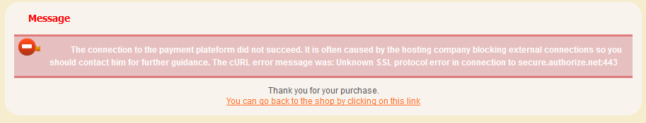

This page pops up just after clicking the checkout and right before the final page. I have no idea where it's coming from or even how to remedy it. My guess is that it's breaking something so the after_end.php isn't displaying the info.
Thanks again!

Did you read the error message displayed ?
  • Posts: 10
11 years 5 months ago #130219
We remedied the error that popped up on check out. Don't know if you want to create a separate resolved post just in case it happens to others. Evidently Authorize.net didn't like that our IP ended in .255 and that caused the error shown. Everything checks out now as far as processing the order.

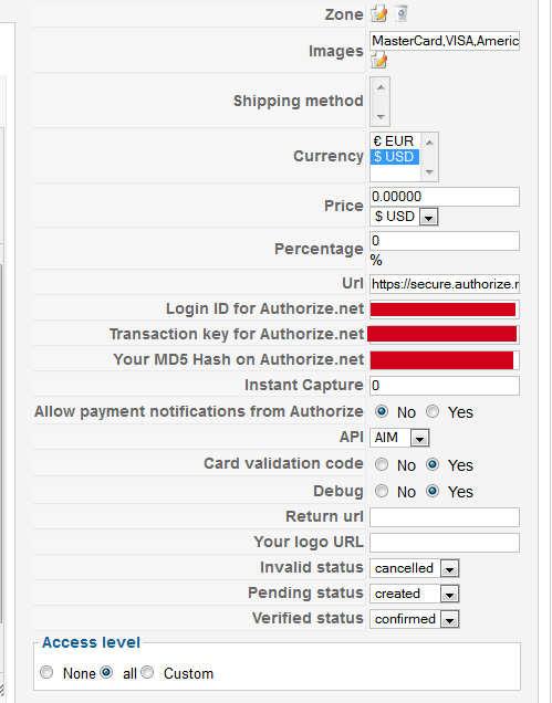

By the way, how did you configure your payment method ? Could you do a screenshot (and remove the confidential data in it) ?
  • Posts: 10
11 years 5 months ago #130580
Bingo! That worked. Attached is the screenshot.
