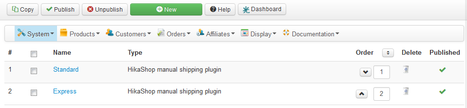

Toolbar
- Copy : Thanks to that button, you can duplicate the manual shipping methods that you selected on the listing.
- New : Enables you to create a new shipping method.
- Cancel : Return to the previous screen without saving the modifications.
- Help : This button enables you to turn ON/OFF the help section, this screen will appear or disappear.

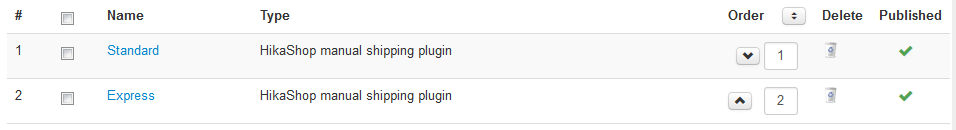

Column Headers
# : An indexing number automatically assigned for ease of reference.
- Name : Name of the shipping method. You can click on it to edit the shipping method.
- Type : Display the type of the shipping method, for example manual, UPS, etc.
- Order : You can reorder the shipping methods.
- Delete : You can delete a shipping method.
- Published : If a shipping method is published it means that it can be used by your customers during the checkout.
