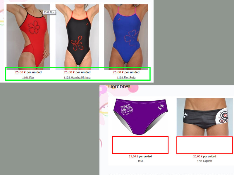

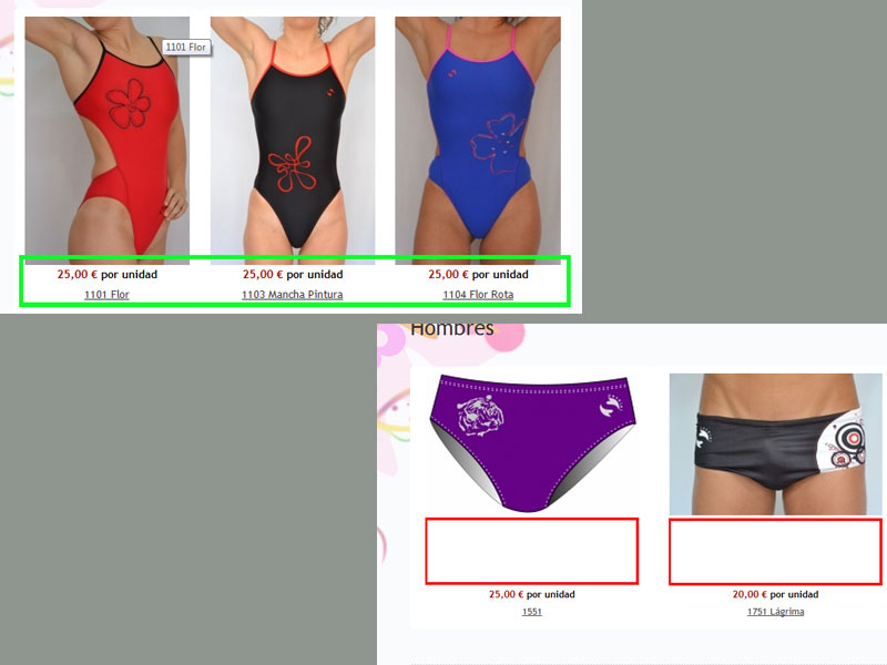

I change size wiht diferent category, but my problem still have not solved, because you wanted to delete the space between image and text.
Looking at the picture attached.
I removed the spaces from the red squares, which remains as the green square.
  • Posts: 83603
  • Thank you received: 13533
13 years 11 months ago #16160
For the red space, you need that CSS:
#hikashop_category_information_menu_ZZZ .hikashop_product_image{ height: YYYpx !important; }

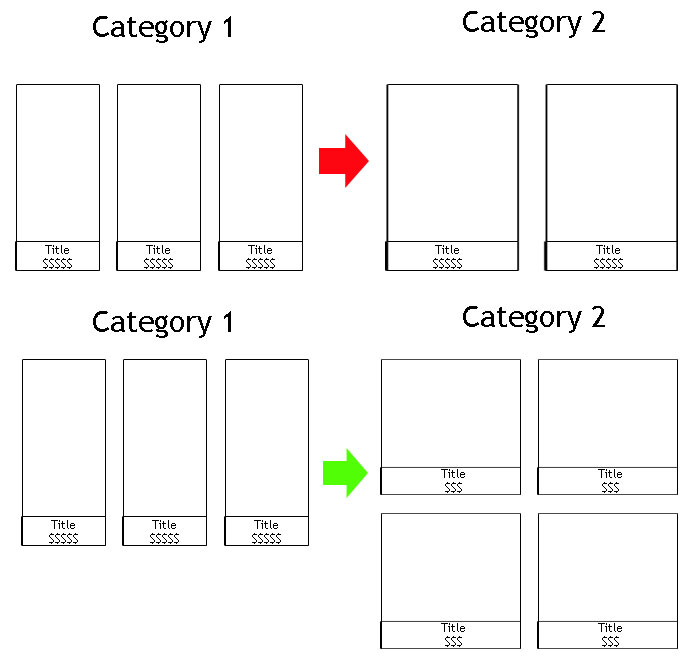

13 years 11 months ago #16163
I think the problem is not in the picture, could be the size of the cell of the table.
You tell me that I change the image but the problem is that both categories have the same table. I think you need to modify is the cell of the table.
Only when I change this celda resize the image in Configuration> Files: thumbnail height and width of the thumbnail
Thanks for fast replies!!!!!
