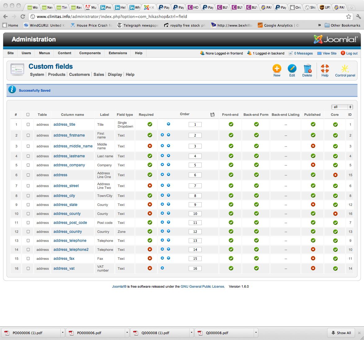

So what exactly do I change in this code? - screen shot shows the custom fields I made

You should use that:
$vars["address1"]= $order->cart->$address_type->address;
$vars["address2"]= $order->cart->$address_type->address_street;
