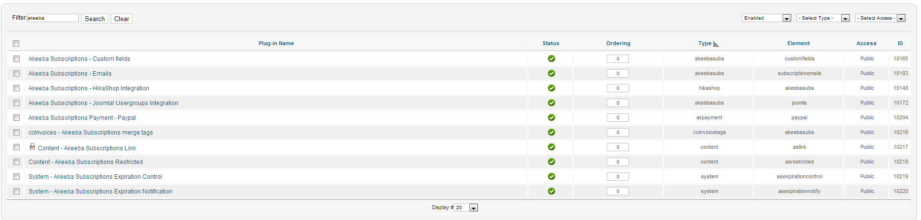

Installed:
Akeeba Subscriptions - HikaShop Integration -active
Hikashop Paypal Recurring Payment Plugin -active
HikaShop Paypal payment plugin -active

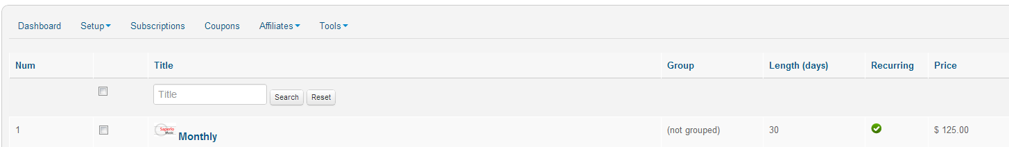

Subscription levels are created and set for "recurring".

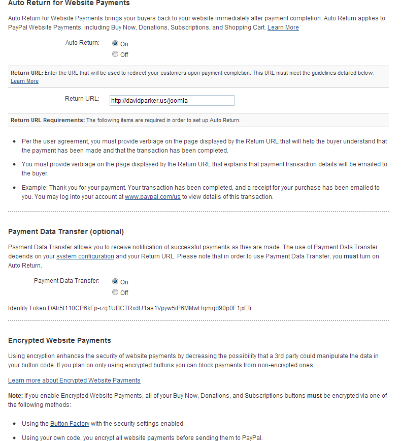

13 years 11 months ago #75088 by parker
Got confirmation working, this was due to incorrect url in paypal account.
Now the subscription show in akeebasubs.

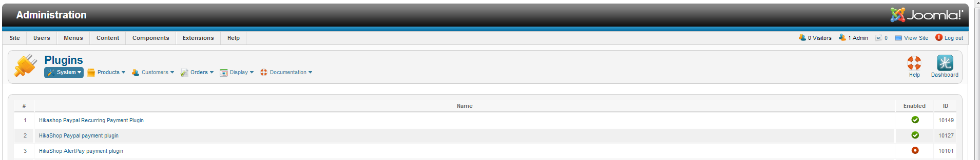

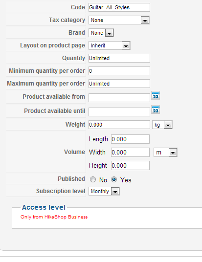

Hikashop product is set with the correct subscription

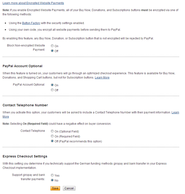

Here are the paypal settings:
By the way, paypal is not redirecting back to the site when a credit card is used. I get a redirect link, but automatic redirection is not working.
However, it does a full redirect if I pay with paypal. This is live payment, not sand box.
Thanks for your help, David

13 years 10 months ago - 13 years 10 months ago #83868 by joomleb
If I want use the recurring payment, both the plugins should be activated?
- Hikashop Paypal Recurring Payment Plugin
- HikaShop Paypal payment
Last edit: 13 years 10 months ago by joomleb.
13 years 10 months ago #83873 by Jerome
Just the paypal recurring one.
