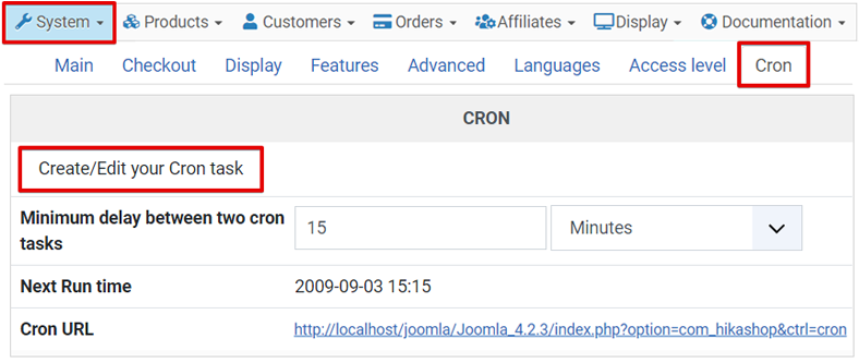

  • Go on your HikaShop configuration page ("Hikashop->System->Configuration")
  • Click on the tab Cron
Create cron
  • On this interface, you can specify the Minimum delay between two cron tasks, which is just for security (so that your website won't be triggered too often) but this parameter has no impact on the real cron frequency (they both should have the same value).

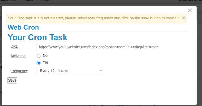

  • Click on the button Create/Edit your Cron task.
  • A popup will open and you will directly see your cron url added (you don't have change it!).
  • Make sure the Cron URL is the right one (you should not have to modify this url!)
  • Activate your Cron Task (if you select "Activated : No", our server won't trigger your website any more)
  • Select your frequency to meet your needs
    You can select either Every 15 minutes, Every 30 minutes or Every 1 hour.
    This frequency should be the same as (or bigger than) the parameter "Minimum delay between two cron tasks"
  • Click on the save button.
  • That's all you have to do and now our server will trigger your HikaShop component at the specified frequency.
  • You have to do this procedure only one time, then you can forget about it!
  • On this same popup, you can also see an area Last Report.
    This area enables you to check if your website has been triggered properly by our server and when.
    You can see our local time, the next time your website will be triggered and the last report.
  • You can now close this popup

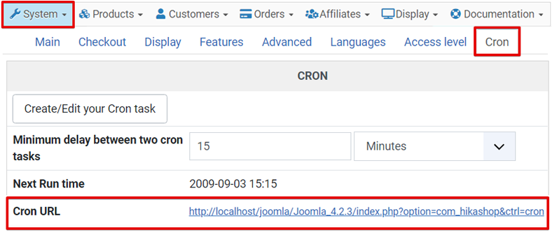

You can see your cron url on your HikaShop configuration page ("Hikashop->System->Configuration"), tab cron.
cron url

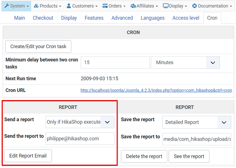

  • We implemented an easy way for you to check that your cron task is working.
  • Go on your HikaShop configuration page ("Hikashop->System->Configuration") and click on the tab Cron
Test your cron
  • On the Report area, you can see an option to have HikaShop sending you a report each time it is triggered.
    So you can turn ON this option and once your done with your tests, you can then turn it Off.
  • Also, on the Last Cron area, you can see the last time your cron has been triggered, who triggered it and the latest report.
