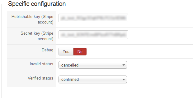

Additional Information
- Publishable key : Enter here the publishable key associated to your Stripe's account (https://manage.stripe.com/account).
- Secret key : Enter here the secret key associated to your Stripe's account (https://manage.stripe.com/account).
- Debug : You can activate the debug mode of the payment plugin. If you do so, informations about each notification received from Stripe will be logged in the payment log file. You can see and modify the location of this file in the configuration page of HikaShop.
- Invalid status : Here, you can select the status to set to an order if the plugin receives a notification from Stripe for an order with an amount different from the order total or in a different currency. In that case, we highly recommend you to check your Stripe account, the order information, and maybe contact your customer, and decide yourself what to do with the order.
- Verified status : Here, you can select the status to set to an order if the plugin receives a successful completion notification from Stripe for an order.
