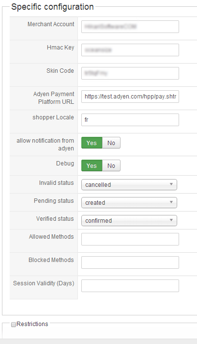

In this part, we will see the primordial options of the Adyen payment method. The only things you will need are your Merchant Account, your Hmac Key, your Skin Code and the Adyen platform Url that you need.

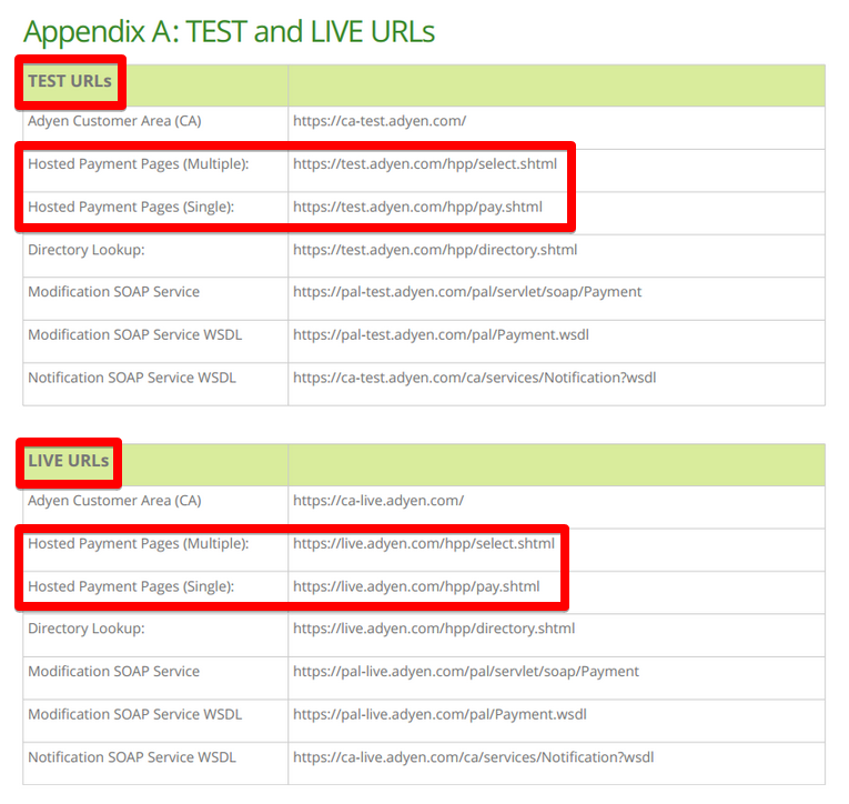

You will find 4 different Adyen platform Url:
Hosted Payment Pages (Multiple) and (single) for Test, AND for the production phase.
  • Merchant Account: Just put your Merchant Account in this field. This identifier is given by Adyen.
  • Hmac Key : Just put your Hmac Key in this field. This Key is define by yourself in your Adyen Sandbox Setting page.
  • Skin Code : Just put your Skin Code in this field. This code is define by yourself in your Adyen Sandbox Setting page like the Hmac Key.
  • Adyen Payment Platform URL: You can write here the Adyen sandbox Url (single or multiple) or the Adyen production phase Url (single or multiple).
  • Shopper Locale: Just complete the Seller Nationality (French: fr).
NOTE: If you want to know more about these Adyen settings, you can look at the step by step sandbox setting page.
  • Now, a little speech about the different options which are proposed by your Adyen Plugin:
  • Allow payment notifications from Adyen: If this option is enable, the automatic response of Adyen server will be treated to update the order status. For example, if the payment has been completed correctly, the order status will be the specified verified status.
  • Debug : You can here enable the debug option of the API. Don't enable this one if you don't have to look into the API's configuration.
  • Invalid status :  Here, you can select the status to an order if the plugin receives a invalid completion notification from Adyen for an order.
  • Pending status : Like, for "invalid status"you can set to an order if the plugin receives a pending completion notification from Adyen for an order.
  • Verified status : Same idea than "invalid" and "pending" status.
  • Allowed Methods :Type here the Methods allow by your Adyen Plugin configuration
  • Blocked Methods : Here, just list all forbidden payments methods by your Adyen Plugins.
  • Session Validity (Days) : Define the order time validity in days.

  • In order to use the Adyen payment method, you have to possess some informations that Adyen know about you, your Merchant Account and,your Hmac Key and your Skin Code, for clear you must create an Merchant Account on Adyen to be able to reach your Adyen setting page. And on this setting page you will enter your Hmac Key and your Skin Code.
  • Later you will enter your Merchant Account, your Hmac Key and your Skin Code in your Adyen Specific Configuration.
  • Enter the Adyen Payment Platform URL that you need among the 4 URL available, you could find these in the Adyen Integration Manual (or just after).

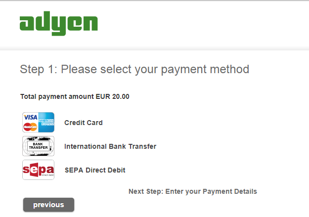

  •  Let's have a look just after the customer click on the finish button.
After the checkout, customers should be redirected on the Adyen payment window.
For the end of the operation
  • Customer have to Choose, among this 3 choice (or less if you use the blocked method) and complete information to validate his purchase on the Adyen platform.
    Later, the order status will be get and save by Hikashop.
