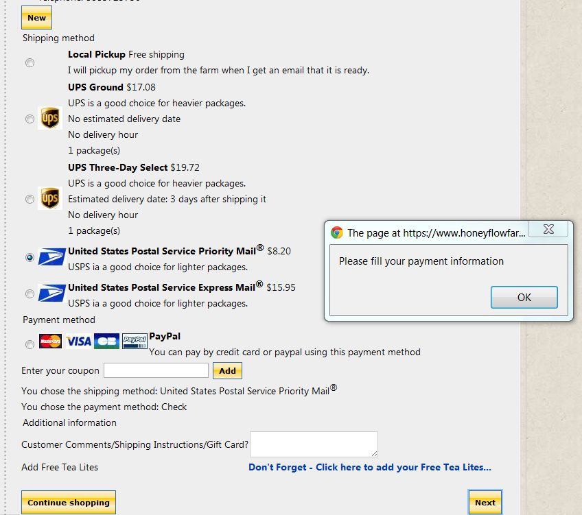

I recently upgraded to Hikashop1.6 and a few strange things happened.
My "Send Check" program is visible and can be selected but will not finish the order - view attached file.
Also, when I add a product to the cart, the small window comes up fine - but stays there (you have to close it yourself). This is not a big problem but it used to automatically close. Is this normal? The program asks to select payment - but it was already done.

In your screenshot, I don't see your "send check" program in the payment methods on your screenshot, and the "select payment" popup is displayed because you don't select any payment method.
In your screenshot I see only one payment methode, PayPal.

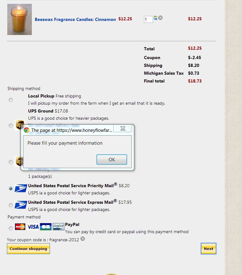

Now, If I check out using a credit card, I can enter the card info but I am forced to go to pay pal. You can see on the image (after entering card info) that paypal & credit card are combined and going forward only goes to payhpal.
