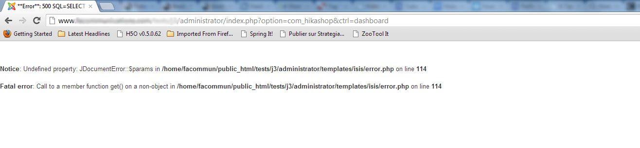

I've followed your steps and in Sytem -> Debut Settings I've set Debut System and Debug Language to Yes and in Server -> Error Reporting I've set it to "Development" and this is what I get:
Notice: Undefined property: JDocumentError::$params in /home/xxxxxxx/public_html/tests/j3/administrator/templates/isis/error.php on line 114
Fatal error: Call to a member function get() on a non-object in /home/xxxxxxx/public_html/tests/j3/administrator/templates/isis/error.php on line 114
And int the title of the page I'm still getting the same error as before.
I can't see the same page as you, I get a blank page with the error, see the image attached.
Hope this helps.
Hope this helps.

We reproduced the problem and we are building a new package with fixes.

Here is a new package that you can use which fixes both problems.

Sweet it solved the problem
Now I can access the dashboard and I can save changes in the configuration.

In Joomla 3.0.1, a new bug has been included.
Please edit the file administrator/templates/isis/error.php and change the line 114
to
and the same thing for the line 120
to
This bug already fixed by the Joomla community and would be published in the next release (3.0.2 I guess).
Best regards,
