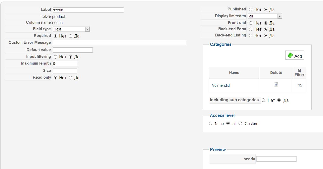

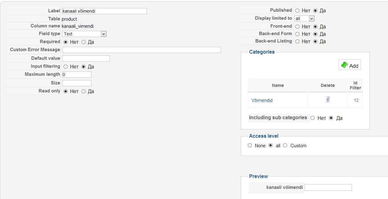

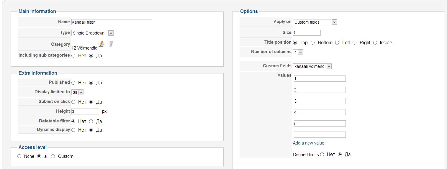

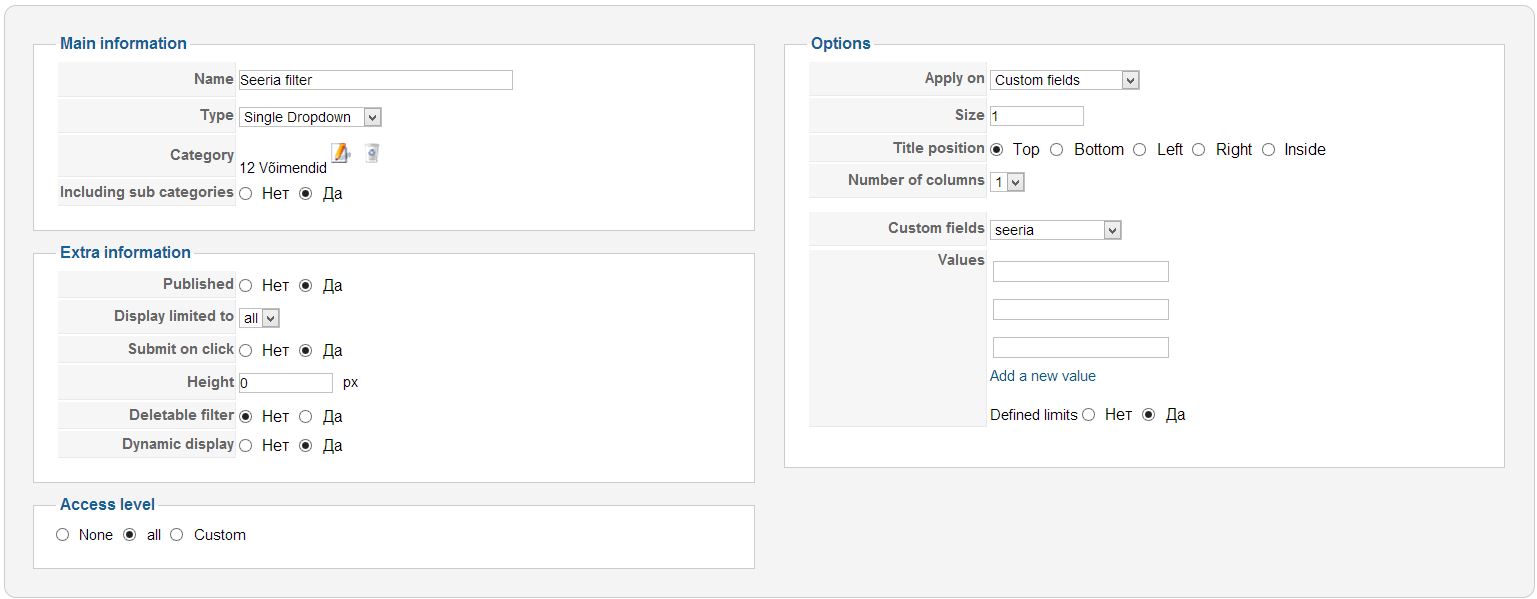

  • Posts: 12
11 years 8 months ago #115858
unfortunately i changed alot of .php files to fit my view9 and i need to start store fast - so i cant update. In future when il have time Il try to modify minimum .php.
can you tell me : if i modify .php through display/view - will it be changed after update?
Here is Series filter. When i put filter values and press SAVE - It delete all values.
Here is chanel filter. when i enter 1, 2, 3, 4, 5 value - It shows 1 to 2, 2 to 3, 3 to 4.... I want just 1, 2, 3, 4, 5
Thanks ALOT!!
  • Posts: 83603
  • Thank you received: 13533
11 years 8 months ago #116657
If you change something via the menu Display->Views, you won't loose it when you update HikaShop as it will be stored as a template override.
Regarding your filter/custom field, you should change the type of the custom to a dropdown and enter your values in the custom field values. Then, keep the filter's values empty and it will use the custom field values automatically.
Also, note that you turned on the "dynamic display' option of your filter which means that you will only see in the filter dropdown the values which are entered for the products of the listing.
