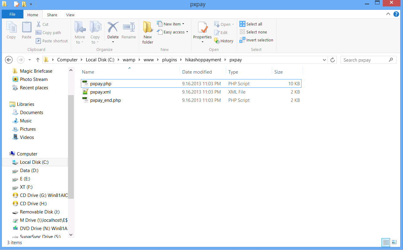

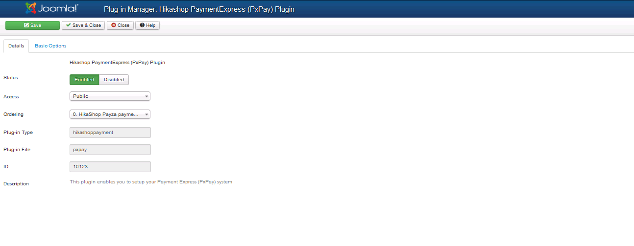

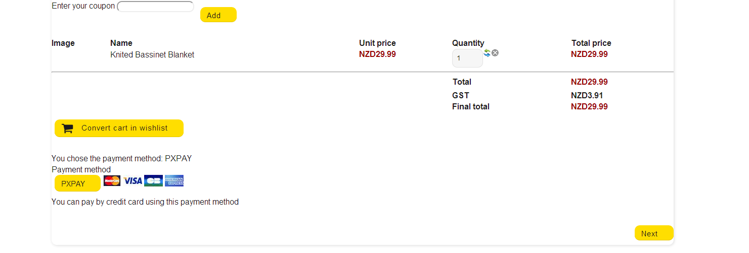

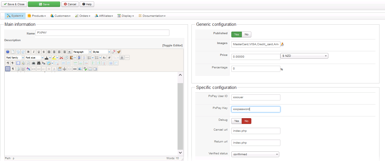

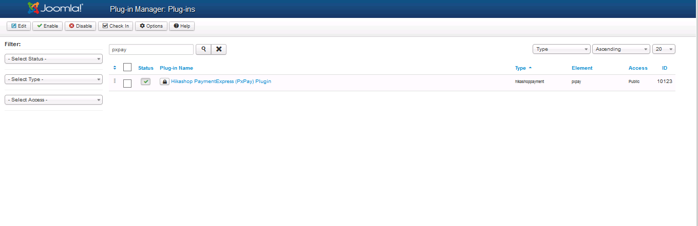

  • Posts: 13
11 years 7 months ago #123779
I done that and installed the pxpay hikashop plugin from plugin manager , published the plugin , add the new payment method with the username and password and published it and deleted the payment express plugin ,
in checkout its saying no payment method found, currency is NZD,
checked even pxpay folder in hkashop plugin and the files are there
any ideas ?
  • Posts: 26223
  • Thank you received: 4035
11 years 7 months ago #123885
class plgHikashoppaymentPxpay extends hikashopPaymentPlugin
	var $accepted_currencies = array(
		'AUD','HKD','SGD','BND','INR','THB','CAD','JPY','TOP','CHF','KWD','USD','EUR','MYR','VUV','FJD','NZD','WST','FRF','PGK','ZAR','GBP'
I see NZD in the list so it should be listed.
Can you please provide a screenshot of you payment plugin listing (in the hikashop backend).

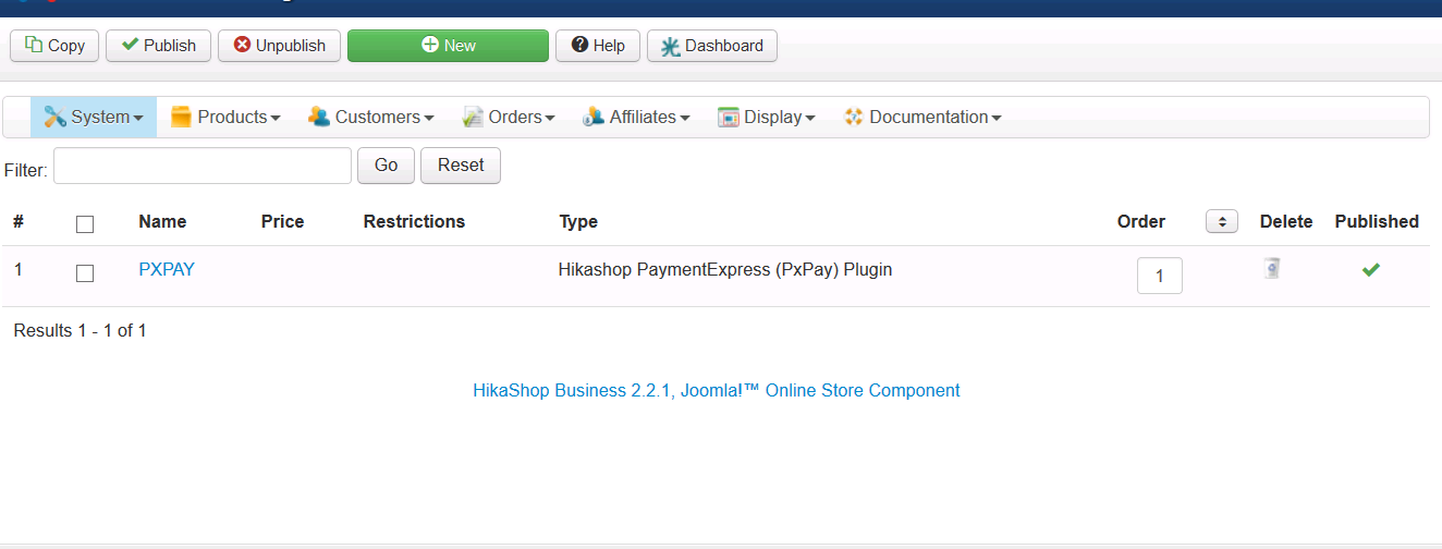

  • Posts: 13
11 years 7 months ago #123905
please find the screen shots
  • Posts: 26223
11 years 7 months ago #123951
Can you re-download the plugin in the post : www.hikashop.com/forum/2-general-talk-ab...-px-post.html#123746
I updated the file manually in order to add some checks.

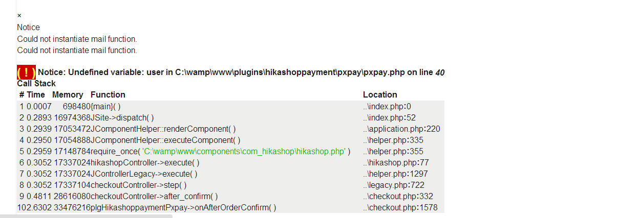

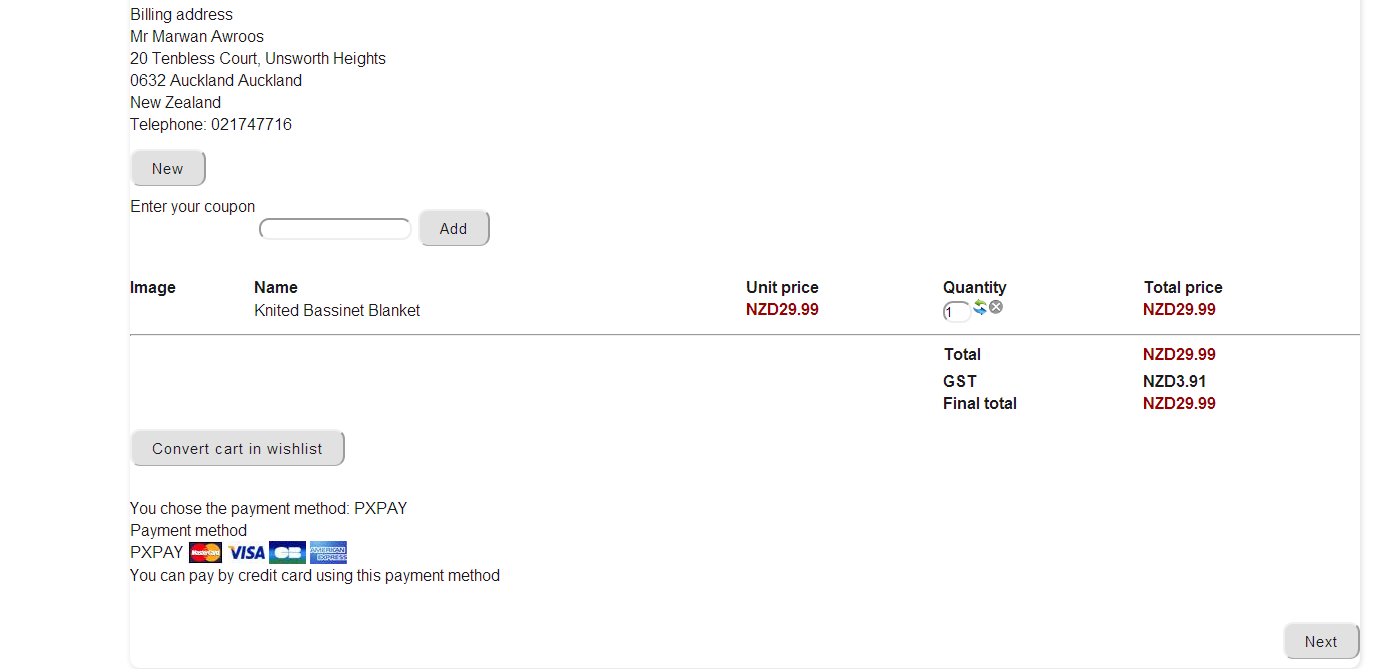

  • Posts: 13
11 years 7 months ago #123966
Hi There
this is better but still not working to the end,
this time it find that there is a pxpay payment but when I press next I get an error message as attached
  • Posts: 26223
11 years 7 months ago #123980
Thanks.
I will update the zip file as possible. But you can edit the pxpay.php file and replace the line 40
<EmailAddress>'.$user->user_email.'</EmailAddress>
By
<EmailAddress>'.$this->user->user_email.'</EmailAddress>
and it will fix the problem.

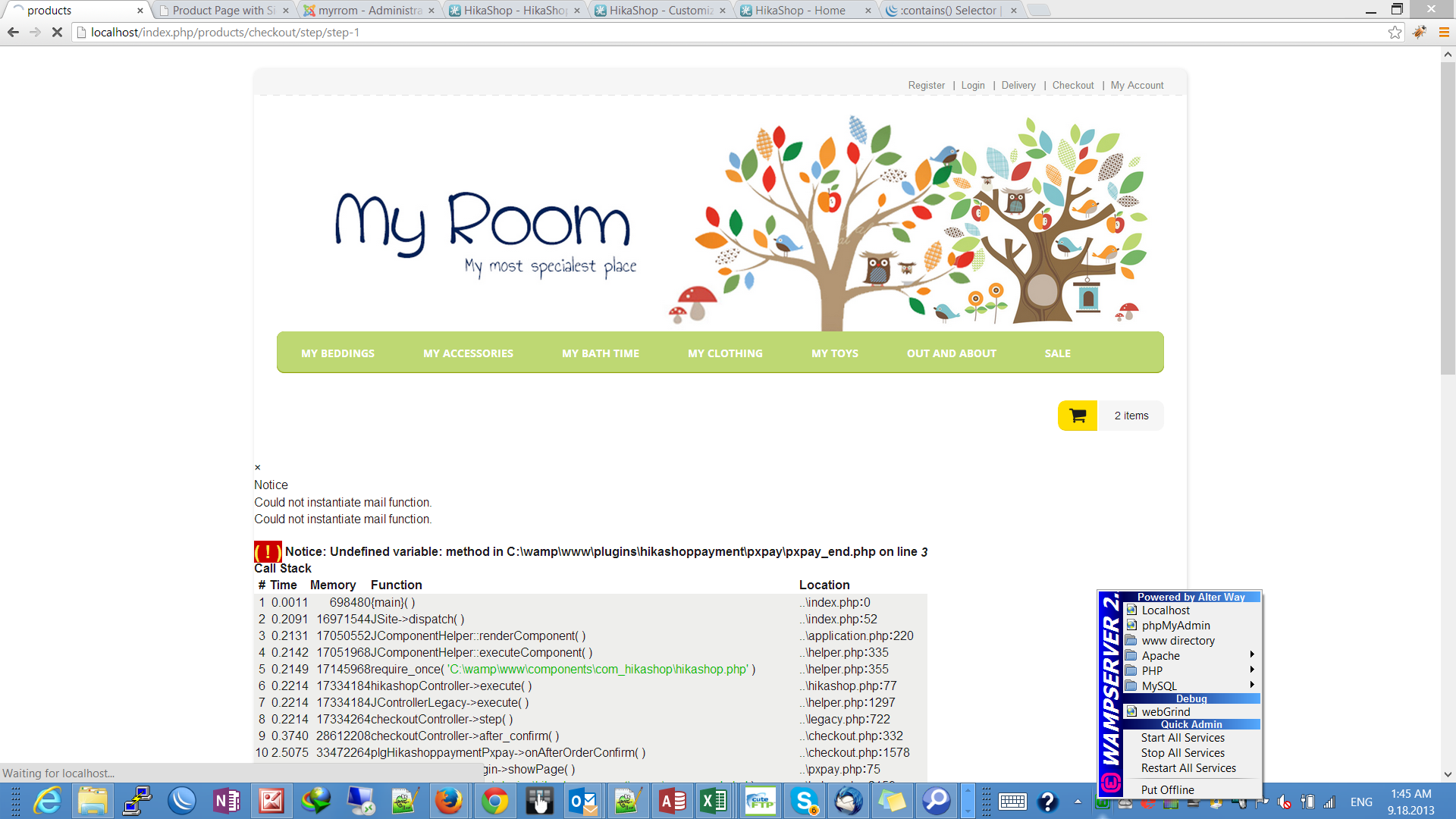

  • Posts: 13
11 years 7 months ago #123987
Hi.
Thanks for spending all this time helping me with this
its still not accepting , its giving different error now
Thx
  • Posts: 26223
11 years 7 months ago #124003
I fixed the end page and update the page with the previous fixes.
  • Posts: 13
11 years 7 months ago #124048
I checked it , it doesn't give any message any more so this is good news,
but it try to send the information and then it say invalid key, I will send the debug details as pm,
there is no place to put the credit card details, so I think this is why it's giving this message....
  • Posts: 26223
11 years 7 months ago #124118
This PxPost plugin does not ask for the credit card in the HikaShop website.
The user is redirected to the Payment Express platform with a special generated token. Thanks to the token, Payment Express can know the order total, the currency, the store user id, etc.
But the user has to enter his credit card information in the PxPost page.
If you have an invalid key message, it seams that your credentials are not right.
You can use the test credentials given in the PXPay documentation:
www.paymentexpress.com/Downloads/DPSECOM_PXPay.aspx/

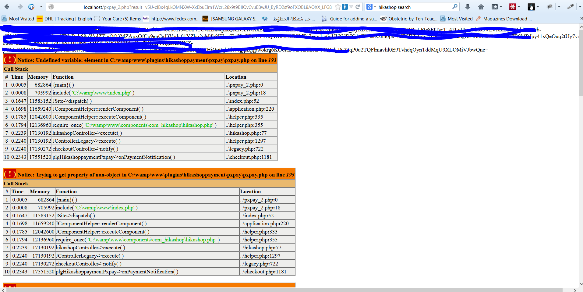

  • Posts: 13
11 years 7 months ago #124134
Hi There
I think we almost done,
I put the correct key and this time it redirected me successfully with all the details to dps, I put my credit card details and and it accepted the transaction but the reply back , i got attached
another thing , it made the order just after redirecting to dps , but I think I can change this through the checkout process right ?
please also look into attached to investigate
