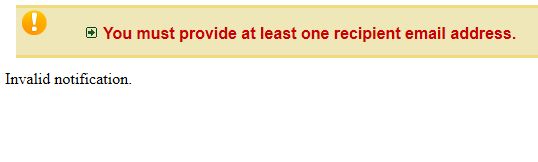

OK, seems I'm following behind in inhouse's foot steps. His posts have been helpful but I've run into something I didn't see in his posts.
On a test submission to FirstData, it now returns me to the HikaShjop site after payment is posted:
That message just quickly flashes and then I'm taking to the Thank You message:
The x_email line has the correct email in the FirstData email and I'm currently checking out as a Guest.

The invalid notification message indicates that the MD5 hash entered in the Authorize.net payment method of HikaShop and the MD5 hash entered in your FirstData account manager settings are not the same.
The error with the email address would indicate that the "Payment notification email" option of the Emails section of the configuration doesn't contain any email address. I would recommend to add one there and that should remove the error.

11 years 3 days ago #152753
Thanks Nicolas,
You were right with the error with the email address - I only set the from and reply to addresses.
I set that and that part of the error went away.
