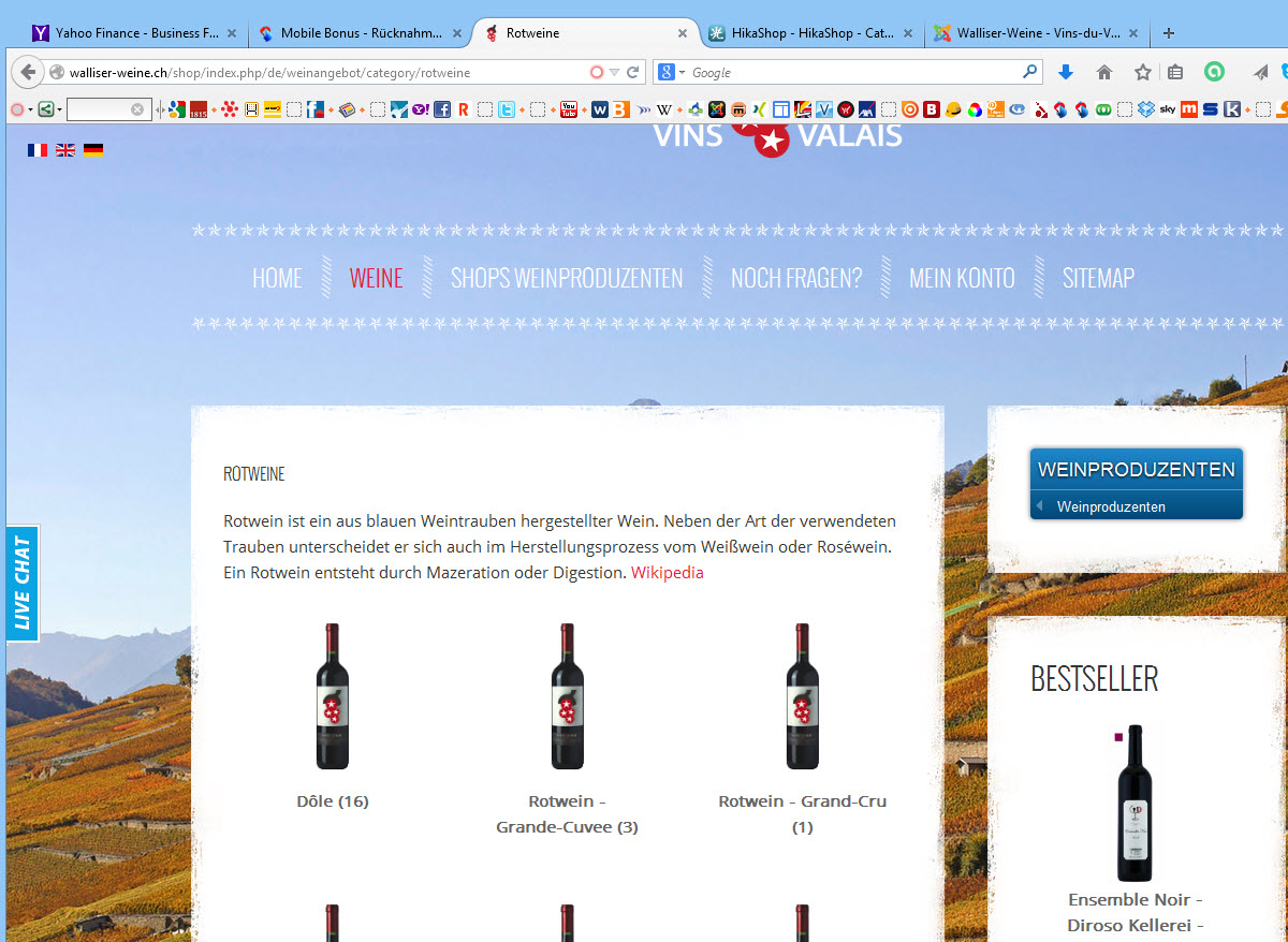

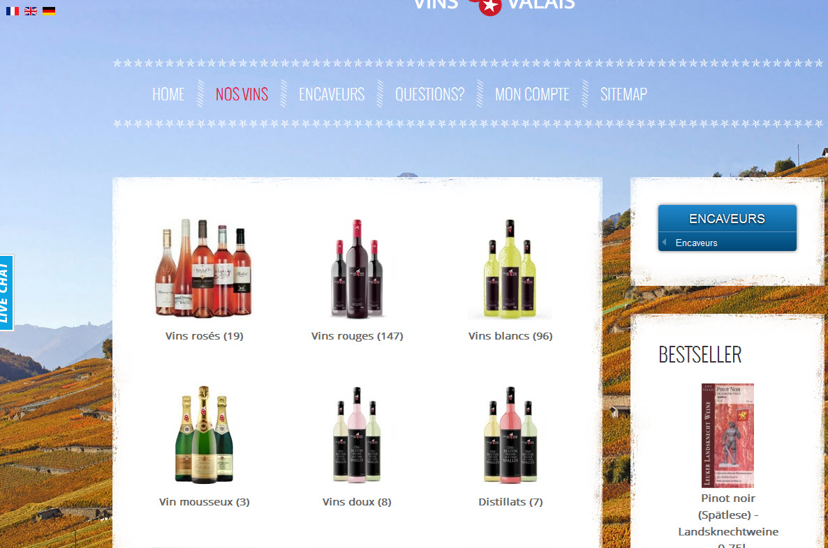

I have some problems to set the language for product categories properly.
Something goes wrong, when i switch the language. when i open a window with category overview:
e.g.: walliser-weine.ch/shop/index.php/de/weinangebot
i can open the category and i can see the products
When i change the language in the category overview page, the categories are translated properly. When i try to open a specific category, it switches back to the original german page. when i enter a authorized URL for the language, the page for the products does not open.

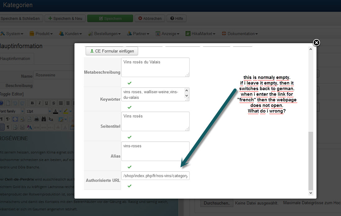

What you need to do is to enter a valid URL in the "canonical URL" of the category. If the page for the products does not open, it means that the link you're using is not correct. For example, this URL is valid:
/shop/index.php/fr/nos-vins/category/roseweine
Make sure that the "alias auto fill" option of the HikaShop is turned on. Otherwise, the system won't look for the translated alias of the category and won't find the vins-roses french alias of the category.

As far i can see, the canonical URL for the main description, german in my case, is filled in automatically. Do i have to define it for the translations allways manually?
This field is allways empty in the translation window. As far i can see now, this is also the case for products.
Markus

You create one mass action via the menu System>Mass actions and set in it one action "update the values" where you select the product_canonical field and don't enter anything in the value field. Then, click on the "process" button at the top to run it.
