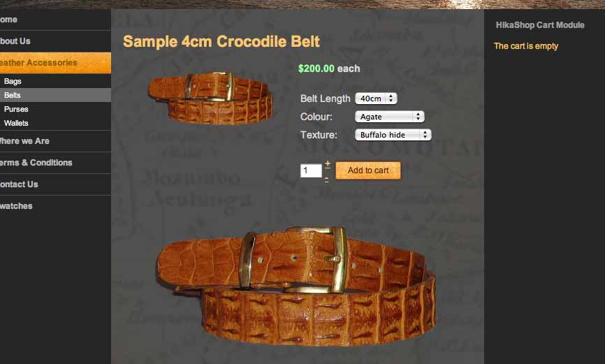

13 years 10 months ago #14681
Here it is. It looks OK as it is, but my friends might prefer just the large image not the thumbnail as well.
It may be that I am being far too picky here!!!!
Thanks,
  • Posts: 83397
  • Thank you received: 13489
13 years 10 months ago #14743
Strange. that should not look like that as the big image should replace the small one. Both shouldn't be displayed with the modification I told you to do.

  • Posts: 105
13 years 10 months ago #15797
Thanks for that - it worked. However, at the moment it is overlapped by the dropdown menu choices.
I would prefer the image either to be above or below those menus, if possible.
Please could you advise how I can do this.
Many thanks,
Kind regards,

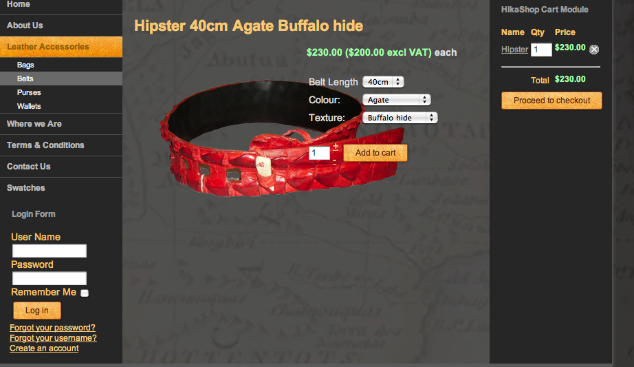

  • Posts: 105
13 years 10 months ago #15798
here is the screenshot.
  • Posts: 105
13 years 10 months ago #15799
I did what you suggested and it worked - great.
HOWEVER, at the moment it is overlapped by the drop down menus - see attached image.
Ideally I would like this larger image to appear below the options or above. Either would do.
Please can you advise.
Thanks.
  • Posts: 83397
13 years 10 months ago #15810
You need to change the CSS of the front end (in the tab display of the config via the CSS edition interface provided) so that the right part is displayed below the image and not next to it. Could you give a link to that page so that we can give you the CSS change to do ?.
