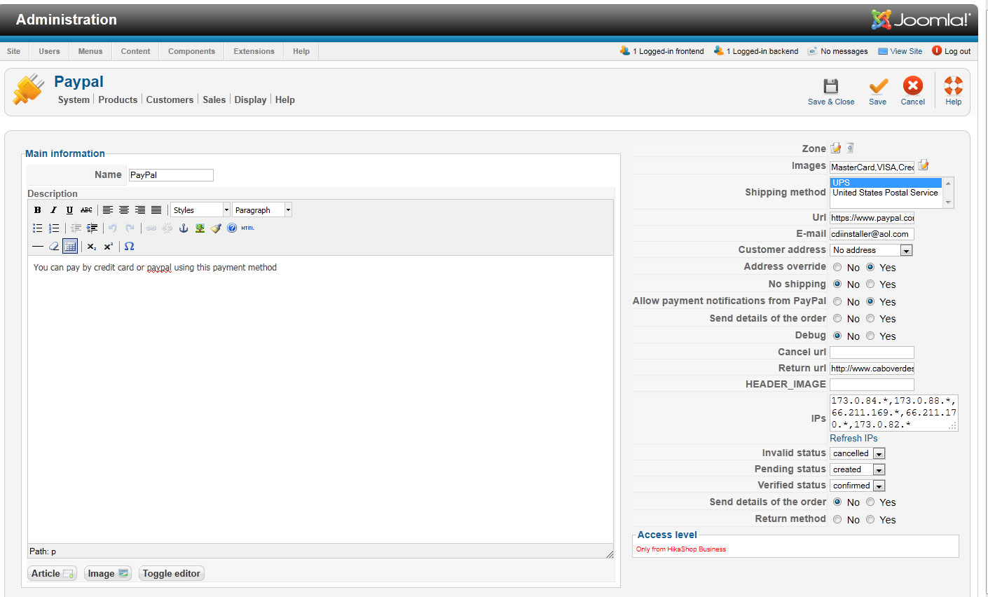

Something really weird is happening, I can't seem to remove or deselect the shipping method under paypal payment method, whenever I try once I saved it, it gets back there again, and another one that's showing there even after it has been uninstalled is the usps shipping method.
I attached both my shipping and payment method screen image, maybe you might find something there that's our of place.
Thank You
  • Posts: 82863
  • Thank you received: 13372
13 years 3 months ago #23070
There is indeed a mistake on that end.
Could you change the code:
if(!empty($element->payment_shipping_methods) && is_array($element->payment_shipping_methods)){
to:
if(isset($element->payment_shipping_methods) && is_array($element->payment_shipping_methods)){
in the file administrator/components/com_hikashop/classes/payment.php and then try again to deselect that option ?
  • Posts: 22
13 years 3 months ago #23081
Worked :-)
Thank you thank you
