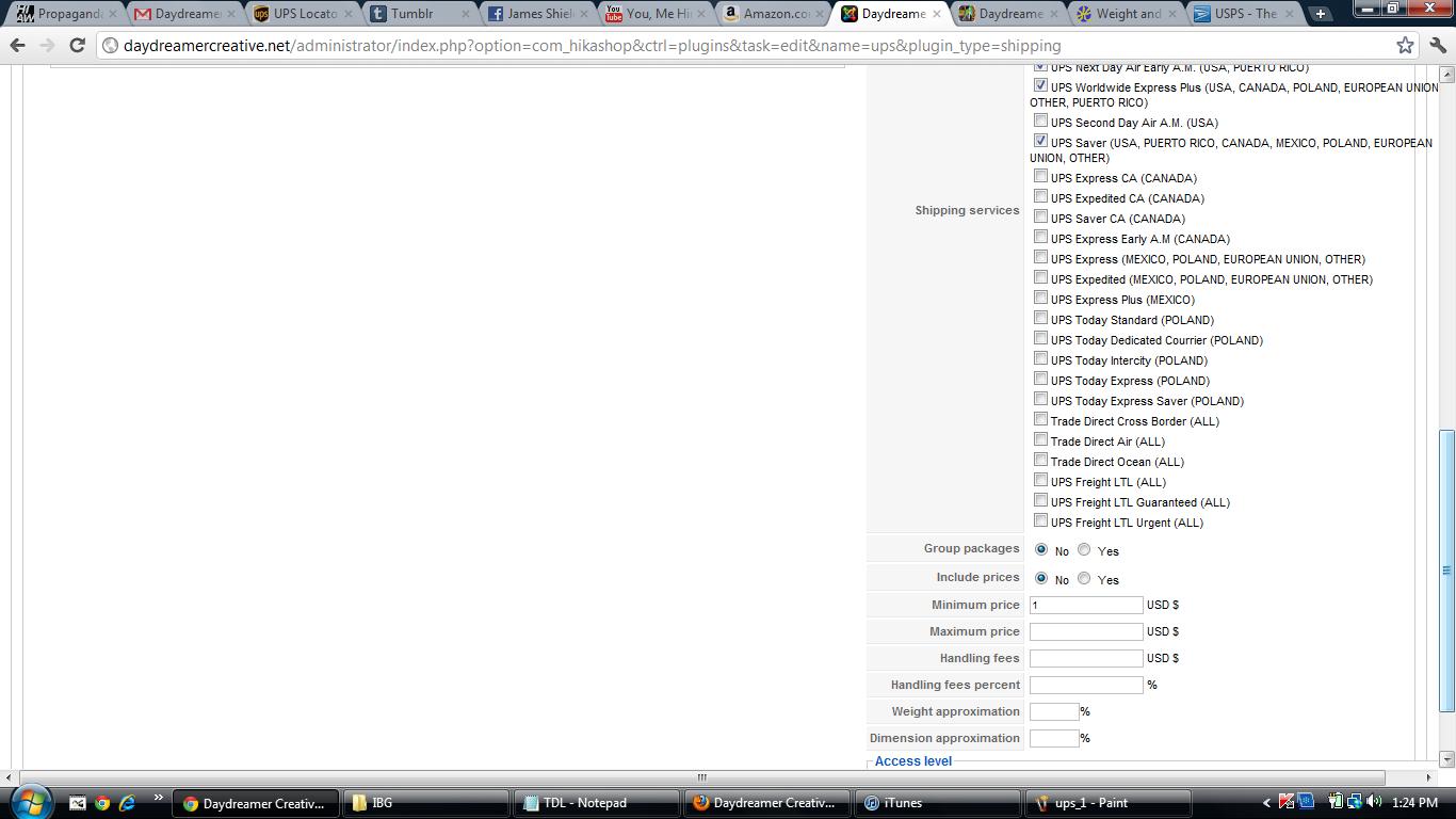

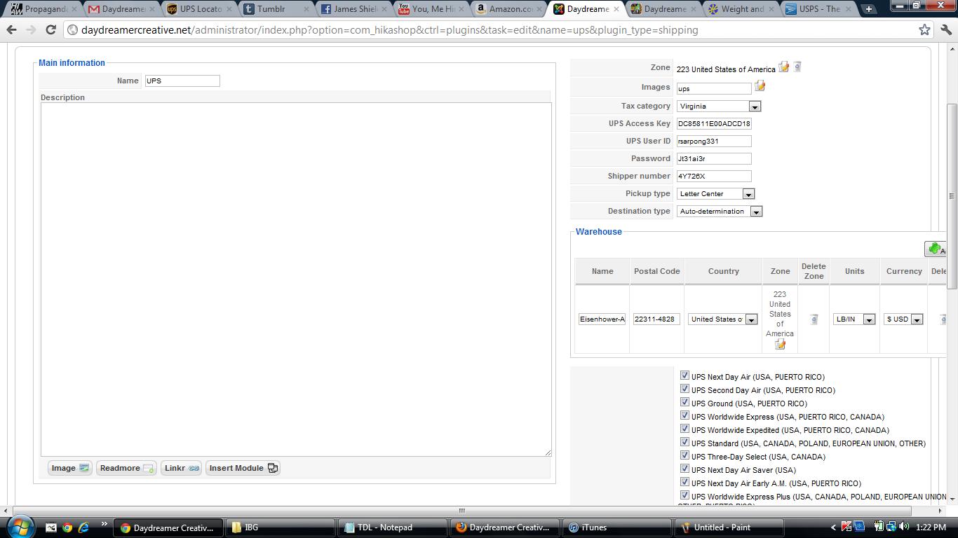

I've enabled the UPS plug in but is not displaying upon checkout. I've attached two screen shots. Thanks for the help.

13 years 7 months ago #25159
Is your address in the USA when you're on your checkout ? Otherwise, the shipping method won't display as you limited it to the USA only with the "zone" option.

13 years 7 months ago #25307
You didn't set the dimensions of your products. That's something which is necessary so that ups can give an accurate shipping fee.
Because of that the ups plugin was not giving any results.
That enabled us to discover that we were missing an error message in that case so that the user can understand what he is missing. I've set fake dimensions for the variant: daydreamercreative.net/administrator/ind...k=edit&product_id=19
and I can now see the UPS shipping methods when I checkout with that variant in my cart.
