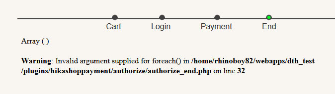

I get the message:
Array()
Warning: Invalid argument supplied for foreach() in {...}/plug-ns/hikashoppayment/authorize_end.php on line 32
and then the screen moves on to show this:
The following errors have occurred.
(13) The merchant login ID or password is invalid or the account is inactive.
I have attached two screen prints. The first shows how the fields do not display for entering the credit card info and the second is the first of these two error messages.

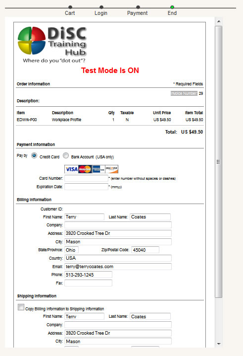

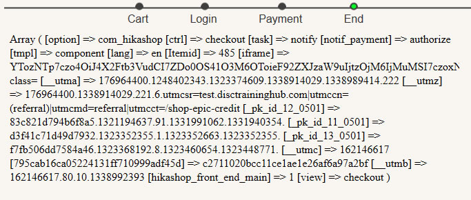

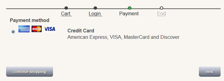

I have tested the updated plug-in. The screen that shows the payment option still doesn't show a place to enter the CC info.
When I hit "Next" a page shows some info and I have attached the print screen for that. Then the page automatically advances to a screen that looks like the second screen print I have attached.
If the DPM screen is going to look like that second screen print, then don't bother working on this any more for me. My current store (running Prestashop) uses DPM and it operates and looks EXACTLY like the AIM version. That is what I am expecting to see here.

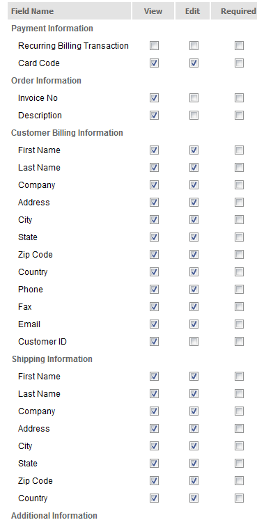

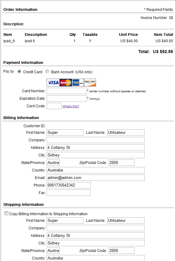

regarding the CCV, you'll have to :
- log into your authorize.net merchant account
- Go to "Account->Payment Form->Form fields"
- set your Payment Form like it's set in the screenshot
And you should have a form like the second screeshot, regarding the error in your first screenshot, I'll try to fix it.

Sorry, I must not have been clear. The first payment screen that appears still looks like the screen shot provided 3 posts back (scroll up to see AuthNet_Screen.jpg). That is what I meant when I said "doesn't show a place to enter the CC info."
But the bigger problem is that I want my DPM screen to appear exactly like it does now when I am using AIM. What you are showing me looks like the Authorize.net screen in an iframe and that is definitely not what I am looking for.
