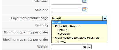

Also, I can see in the HS demo site a field in the product setup called "Layout on product page" as seen in attached pic. Is this new to 1.5.6? How does it work? There does not appear to be anything in the help files.

For that new option it allows you to select a different layout for the product page.

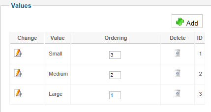

  • Posts: 209
  • Thank you received: 18
11 years 10 months ago #99451
Hi Nicolas, that would be great except it doesn't work. Changing the order of the variants in the characteristics window has no impact on what is displayed on the front end. See pics.
Maybe I'm missing something and would be very happy to know how this is done.

  • Posts: 83397
  • Thank you received: 13490
11 years 10 months ago #99462
Then it means that you changed the HikaShop configuration option "Characteristics values ordering" to something else than "ordering", which is the default value, and because of that it is ordering the values on something else that the ordering that you entered.
I can assure you that this has been working since a long time in hikaShop for everyone.

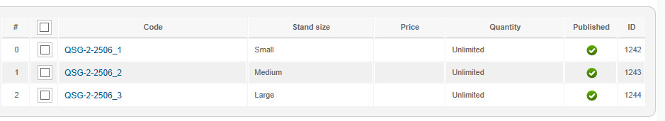

11 years 10 months ago #99489
Am I missing something ? Changed nothing in the configuration. and please see below.
My product characteristics are as follows :
Then when I click 'Manage Variants' I get :
as you can see, not ordering on variants ?

  • Posts: 83397
11 years 10 months ago #99503
Please check the option "Characteristics values ordering" of the configuration and make sure that it is set to "ordering" and the values of the characteristics will be ordered based on the ordering on the frontend.
As I already said, the "manage variants" listing is not ordered based on that.
  • Posts: 179
  • Thank you received: 17
11 years 10 months ago #99525
Ahh ok, gotcha, have put to id and now working.
