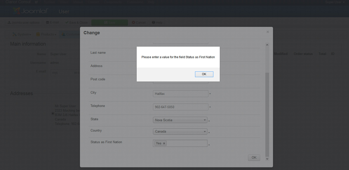

Closed the browser and cleared cache and tried again, this time I decided to publish vat_address to the frontend and renamed it "Status as First Nation" (in Canada they are tax exempt) then going through the registration process I tried to enter the customer again and it tells me I need to enter a value for the vat_address and if I choose anything other than Yes, it keeps repeating to enter a value in vat_address (this is on both the front end and back end)
Edit:
I found part of the issue was related to the vat_address being set as required, once I removed that it would update and allow me to register.
Found another issue though, once the vat_address receives a value (by selecting the Yes from the drop down, where the value=yes) this cannot be undone for that address. To remove the entry the address must be deleted and re-entered as No (from the drop down, where the value= ).
Is there another way to remove the value from vat_address?

You should change the type of your custom field from "multiple dropdown" to "single dropdown".
