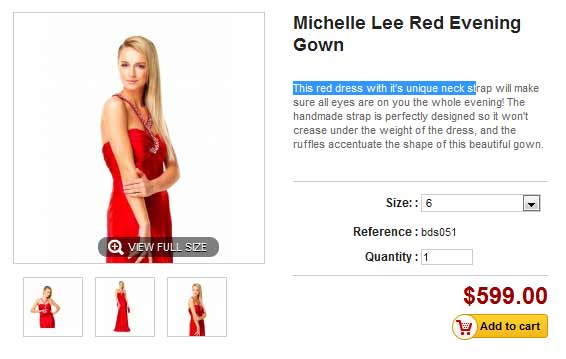

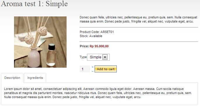

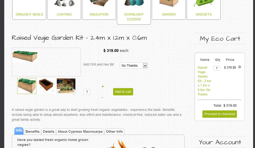

Have attached an image of the product page currently on my site (Mockup). I am having trouble finding where things are in views to manipulate the layout. A couple of things.
I want to basically make the Hika layout look like that shown in Mockup2 image (which is prestashop)
How do I make the Main product image larger (the thumbnails below are ok)?
It looks like that if things aren't being used such as vote, or dimensions - it is leaving blank space where they are normally located - you can see the spacing. Not sure how to stop this.
How do I get the intro text (before the readmore in my product description) to sit on the right hand side where the price and characteristic currently is.
My order would be
Product Description
Characteristics
Quantity
Price
Add to Cart
Much the same as the Mockup2 image,
I want to add the word quantity in front of the text box as well - not sure which view
Hopefully this makes sense

Would you know where the code is located that holds the table with the quantity and the plus and minus signs to increase/decrease product stock, and the Add to cart buttong on the product page? Can't find it in the views anywhere - thought it might be the view product quantity but can't see it in there. I need to style this particular table only. You can see here under the price www.ecomad.com.au/ecomadBamboo/shop-cate.../product/cid-32.html
Cheers

All I want to do is amend styling. It would be good if each of the separate sections like the product page price and the module cart price for instance have their own CSS ID - as I have found it hard to change one thing without it changing another using CSS. The table in the product page which I want to change doesn't have a CSS ID or CLASS assigned and any changes I make to a table affect tables everywhere. This would make it simple to change styling of elements. But I might be missing something :)
The only other thing I wanted to do with this section is add the word Quantity in front of the Quantity text box. And it would be nice if it had similar look to the checkout where you get the refresh graphic. Will keep tinkering to see if I can do it

The page is here: www.ecomad.com.au/ecomadBamboo/shop-cate.../product/cid-32.html
I am trying to move the section where it has quantity, the plus and minus, and Add to Cart to the right. Also there is too much space between the + and - signs. And I want to add the word quantity in front of the text box. When I look at the source code of my page the table itself has no id or class.
<span class="hikashop_product_stock_count"></span>
<table>
<tr>
<td rowspan="2">
So I am not sure how to do this.
Thanks for your help.
EDIT: Have managed to right align that table but I can't seem to make the table padding smaller. Still having trouble with a few other styles like setting a height for the table and manipulating the padding / margins for the table.
Last edit: 12 years 10 months ago by Huski.

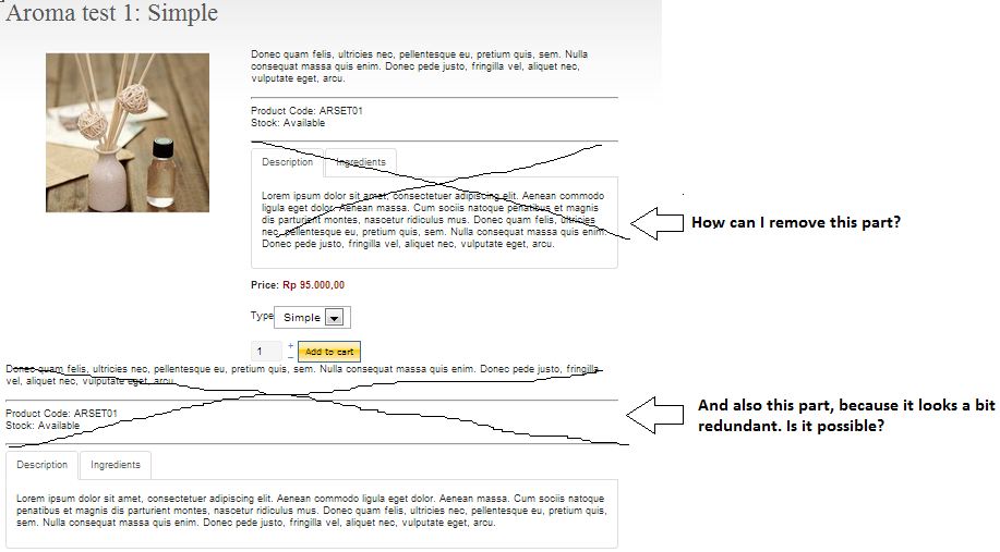

Hi first of all, thanks for this thread Huski and rikatos. I have followed the steps and I manage to make the product description to appear on the right part. However, it puts everything in there including tabs where I actually want only the description before the tab. I have tried to fix it for some time but to no avail. Huski, you managed to fix it, what exactly did you do?
Please see the screenshots attached. Mockup is as-is and Mockup2 is to-be.
Many thanks in advance guys.
Last edit: 12 years 1 month ago by max.mandias. Reason: more clarity

12 years 1 month ago #95774
Basically you are talking like my quote site ?
www.glcportal.co.uk/leisure/product/560-kru-xs-iso.html
Just that I have removed pricing:)
  • Posts: 12
12 years 1 month ago #95775
Yes! I want it exactly like that. What should I do now?
  • Posts: 179
  • Thank you received: 17
12 years 1 month ago #95785
From my memory all I did was change product/show.php files within hikashop (Display..Views..Filter by Front end and your template).
This allows you to edit the override file (ie if you mess it up you just get rid of your override and all returns to default).
I will pop across (attached) my show.php file so you can paste over and see if it fits your needs. Naturally I recommend doing on a test site not a live one !
Last edit: 12 years 1 month ago by rikatos. Reason: attachment
