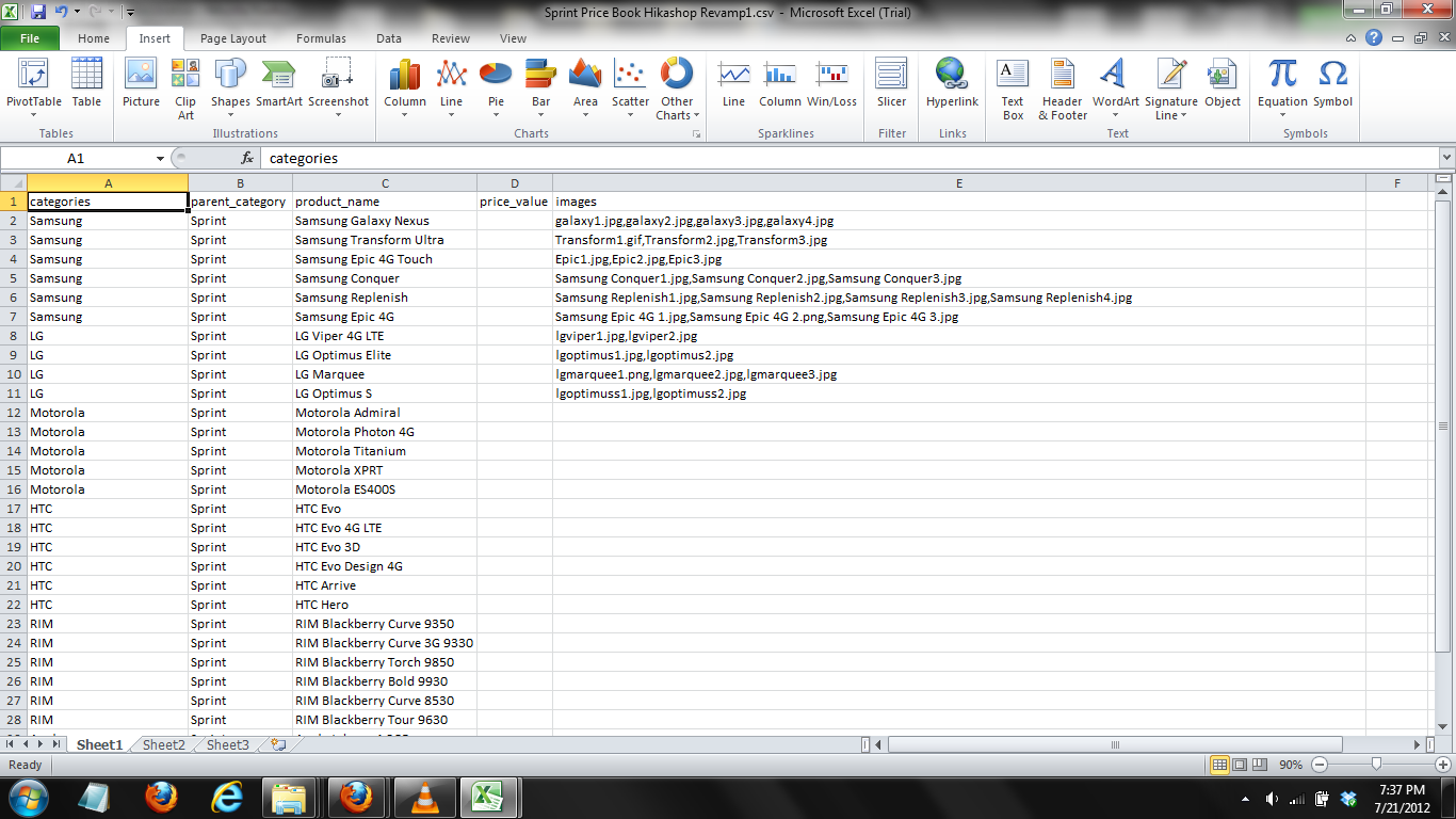

Ok I'm having issues again.
Everything was fine, then I deleted one a category and after I re-uploaded the csv, the images are the standard bar-code picture again.
Here is the link to the page
phonequote.org/index.php/priceguide/sprint
I have attached a screenshot of my csv (ms-dos)

I think that maybe your problem comes from the case of your images. You should try to put your images name in lower case. That might help.

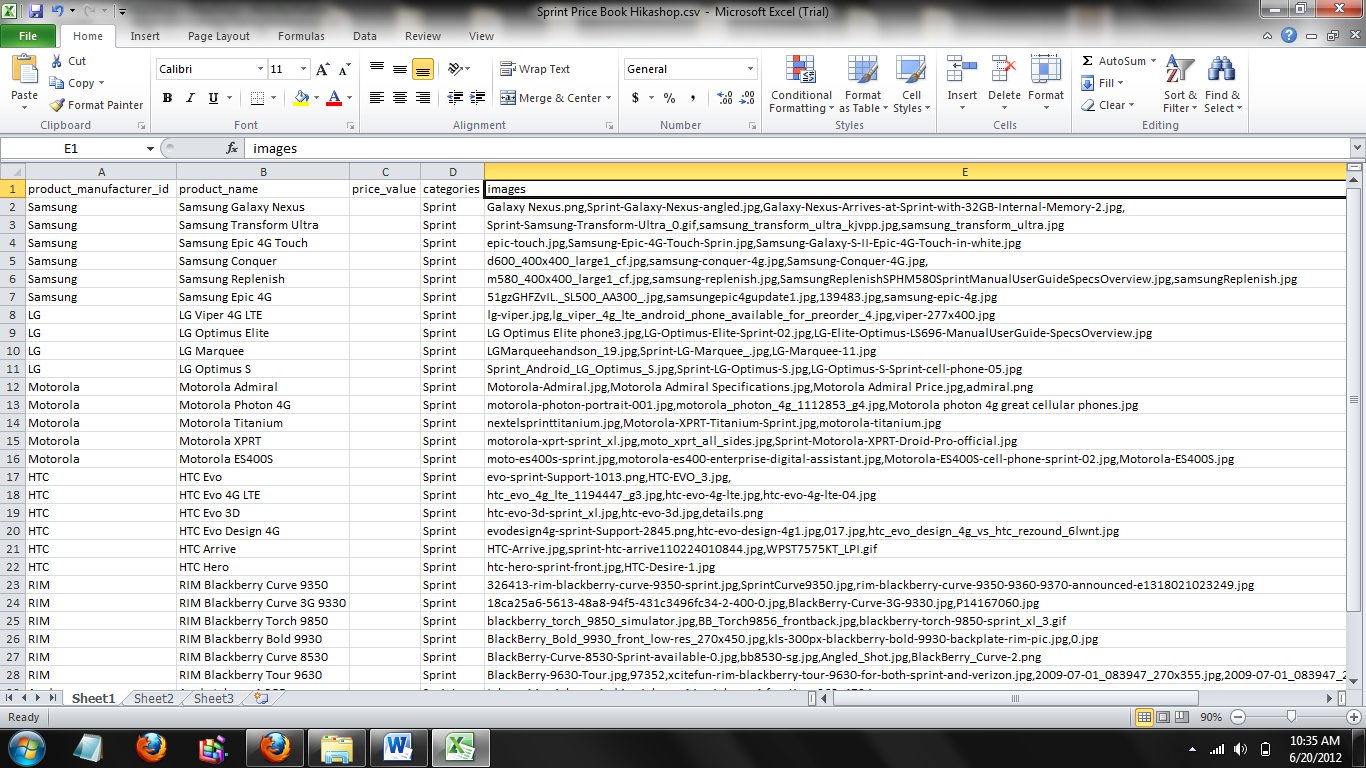

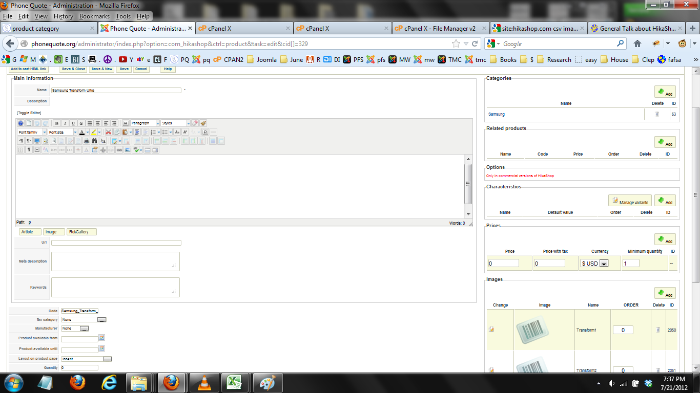

  • Posts: 18
12 years 9 months ago #58326
For some reason it's still not working.
Windows automatically makes the first letter of the word capital when I edit the name.
In the excel doc, I made the image names all lower case, and no luck.
I also tried making just the first letter capitalized but still no luck.
I shortened all the image names and removed any characters like underscores....
I am so frustrated, especially because it was working before!
I have uploaded the images to the correct place, media-com hikashop/upload
What do think is the issue?
Here is a screen shot of the excel doc and the back end of the product page
