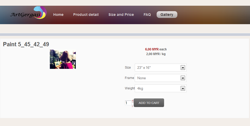

12 years 9 months ago #57059
i would like to know where can i adjust d image size?(refer to d attach file) because it quite small at here

Go in the tab "Files" in the configuration and change the "product page image width/height" options.

12 years 9 months ago #57177
thx ya but may i ask wat is d number around dere (45_42_49) i think i din set this up anyway can i disable it?

That number is the product code. You can remove it by turning off the "show product code" option of the configuration.

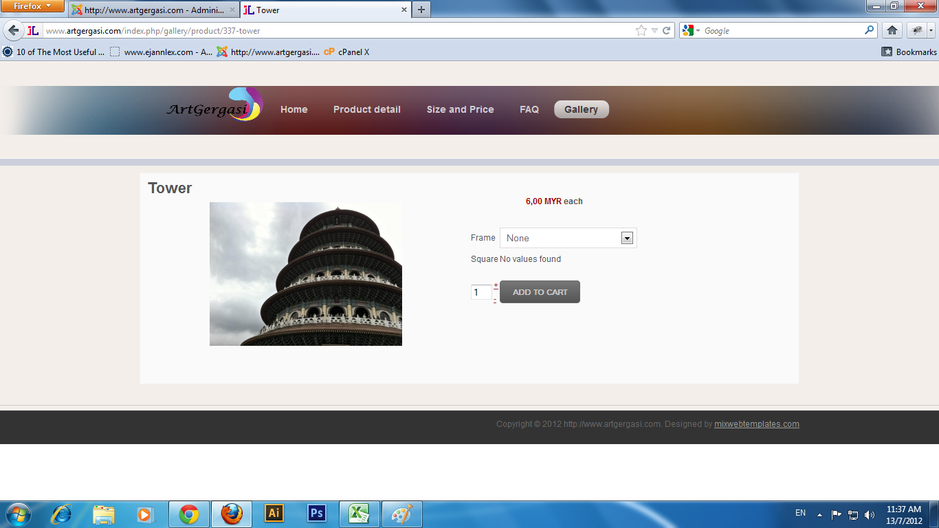

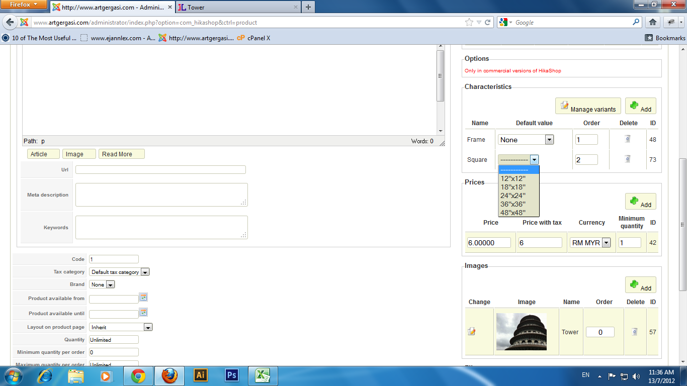

12 years 9 months ago #57298
Sorry ya i noe getting annoying cos too many problem i hv but may i noe y d product dere show no value found? i hv set d price like in d attachment there...

1. There is a message which either says that the message has been sent or that there was an error.
If you don't see it, it's potentially coming from your template:
www.hikashop.com/en/support/documentatio...issues.html#messages
Maybe it's something else like a javascript error. In that case, we would need to look at the page in order to tell you what to do. Could you give a link to the page ?
2. If you want to have your users upload images, you can create custom fields of the table "item" and of the type "image" via the menu Display->Custom fields with the Business edition.
3. That's because you added the characteristics in two times. You should add them both at once. Please follow these steps and it will work:
1. Delete all the variants of the product on the listing of variants that you can access via the button "manage variants" on the product edition screen.
2. Delete the characteristics of the product.
3. Save the product.
4. Add the characteristics again.
5. The system will regenerate all the variants automatically and you should be able to see the dropdowns properly on the front end.

dis is my website link...and thanks for the variant problem i solve it ady
