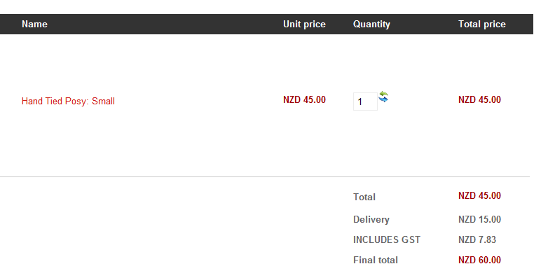

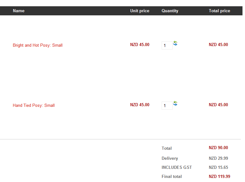

when I tested buying two different items, the calculation of the delivery cost in the checkout is slightly different, please see the attached screen shots. Delivery for one item = $ 15, two items = $29.99
I am using "shipping price per product", your solution last time fixed the calculation for buying several quantity of the same item.

12 years 9 months ago #57103
Hi shanwell,
These difference can come from the calcul of the shipping fee which is based on the taxes, on on the product price.
In this example, is the product price with taxes or without ?
Can you give me the configuration of your taxes, and shipping method.
Maybe you can try to adapt the percentage of the shipping fee, for example set 12,001% instead of 12%, to counter this rounding.
