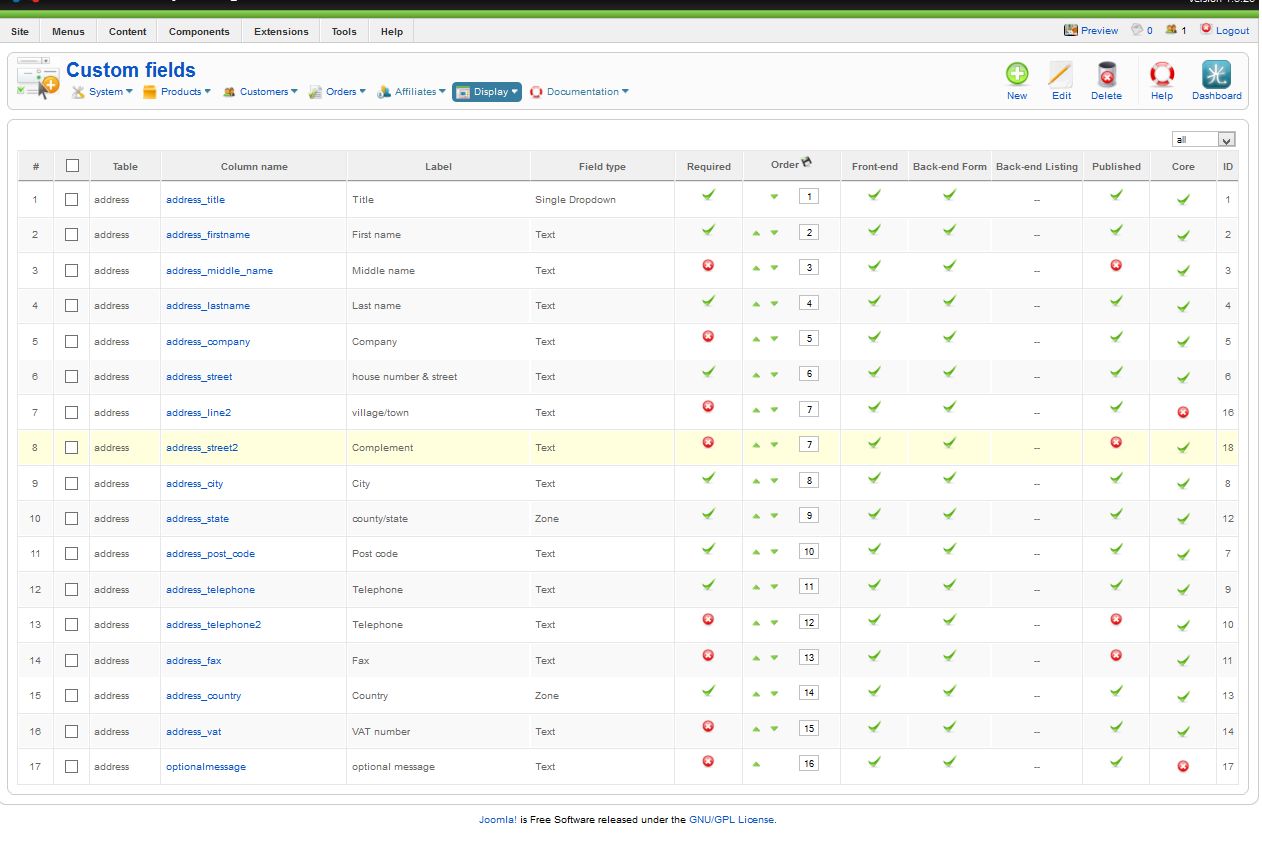

11 years 10 months ago #84328
Have you disable the registration ?
Can you give us a screenshot of your custom fields ?
Try to install the latest HikaShop version from our website.

11 years 10 months ago #84349
hi,
registration is not disabled - I have 'registration' selected on the checkout configuration page.
I have attached a screen shot of my custom fields page.
I'll install the latest version from the website asap and let you know if that makes a difference.

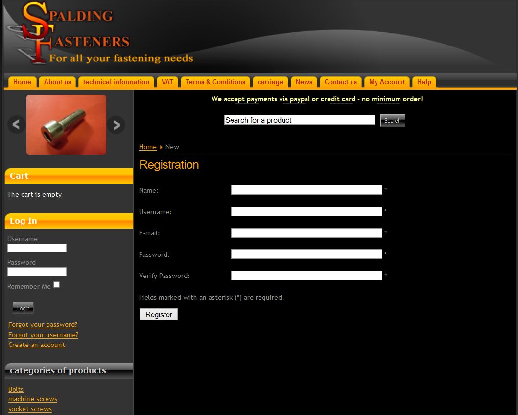

  • Posts: 90
11 years 10 months ago #85616
hi,
I've attached a screen shot of the registration page.
kind regards,
Tanya
  • Posts: 26158
  • Thank you received: 4028
11 years 10 months ago #85643
It is the joomla registration view, not the HikaShop one. So we can't display HikaShop information into it.
  • Posts: 90
11 years 10 months ago #85943
Thanks- I managed to sort it. It turned out that the plugin for redirecting the registration from joomla to hikashop was not active so I had to activate it in the plugin section of the website.
Thanks again for your help.
kind regards,
Tanya
