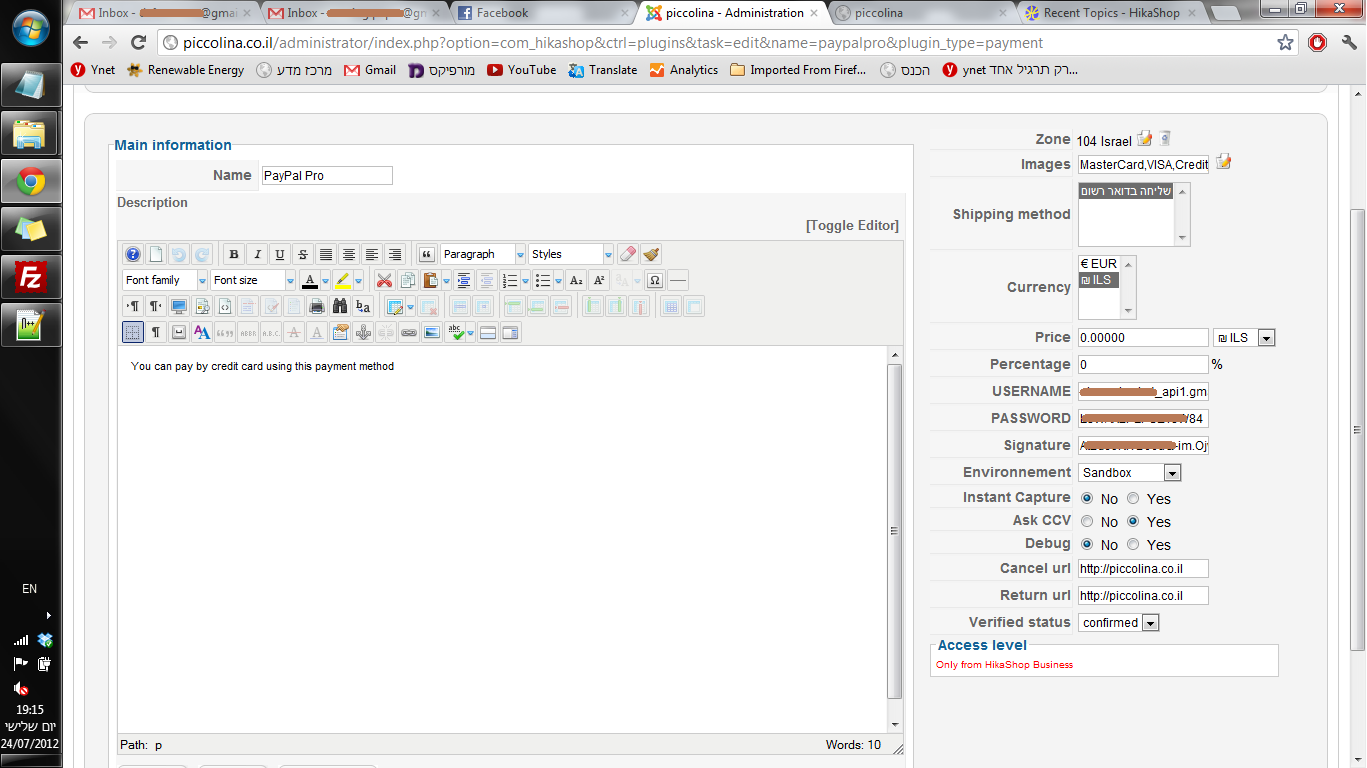

attached a screen shot of the config in the paypal pro hikashop plugin.

Please remove the zone restriction and unselect the shipping method and the currency (press the CTRL key and click on the selection) in your payment plugin options and then it should hopefully display.

I played with the zone and it did removed half of the error.
Now I only get "No payment methods found".
How could that be if i have the paypal advanced on enabled?
Again, thanks.
  • Posts: 83603
  • Thank you received: 13533
12 years 8 months ago #58953
Oh I didn't saw that your were using PayPal Pro.
That's the problem.
PayPal Pro only supports Canada, USA and UK. So you can't use it if you're in Israel.
That's a limitation set in place by PayPal itself.
You will have to use another payment gateway like PayPal standard, Skrill, or AlertPay.
