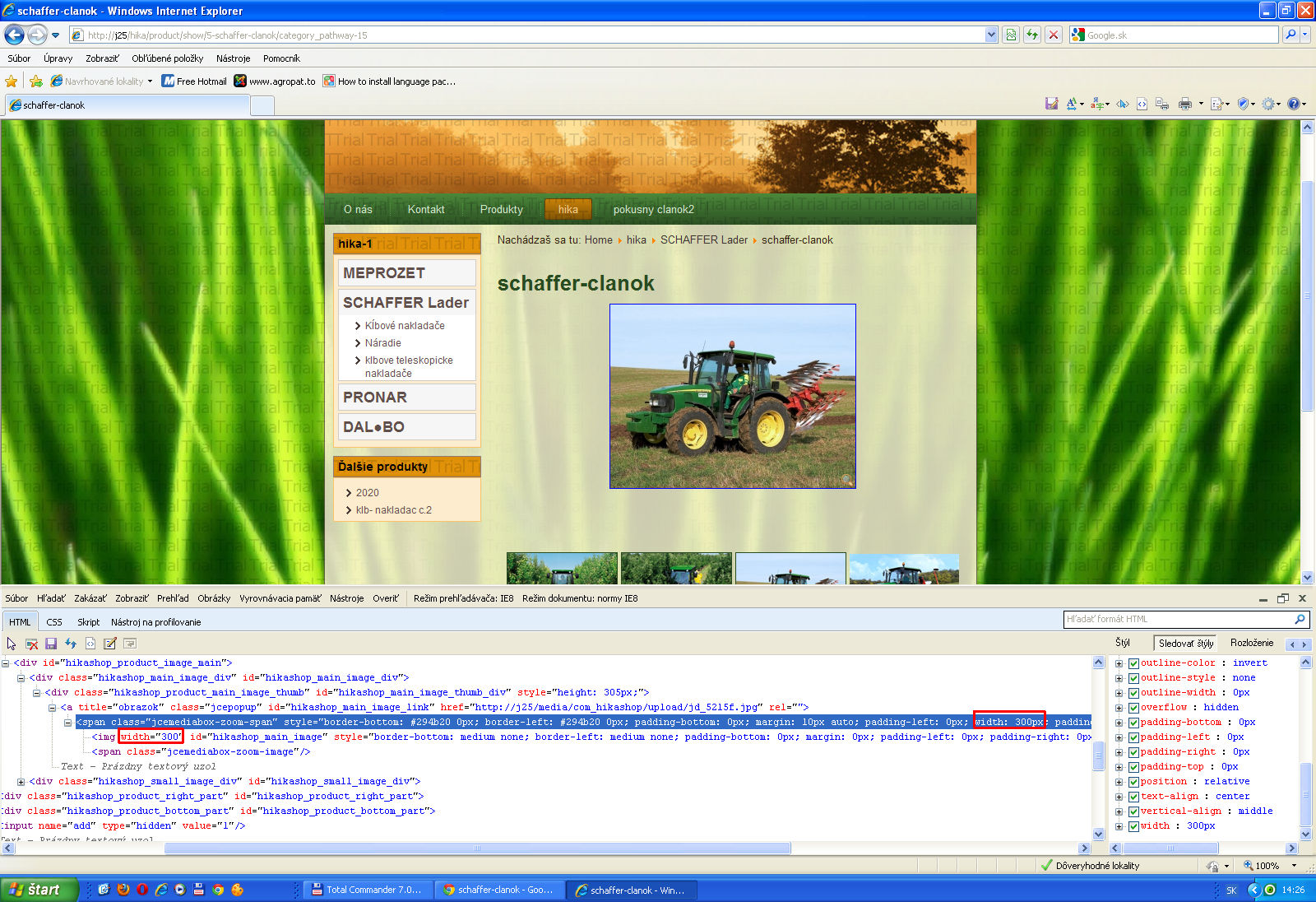

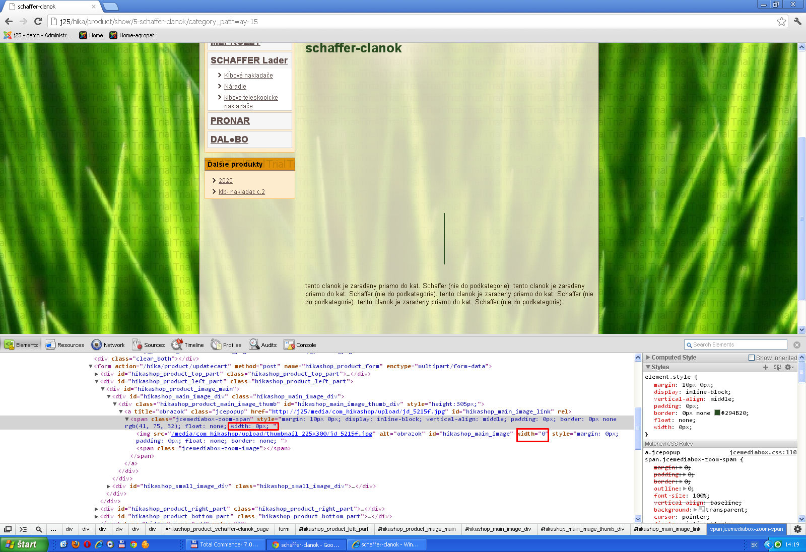

  • Posts: 17
12 years 8 months ago #60649
I send 2 screenshots - I think, that problem is "width". In IE is correct, but in Chrome is 0px. Maybe it will be useful.
