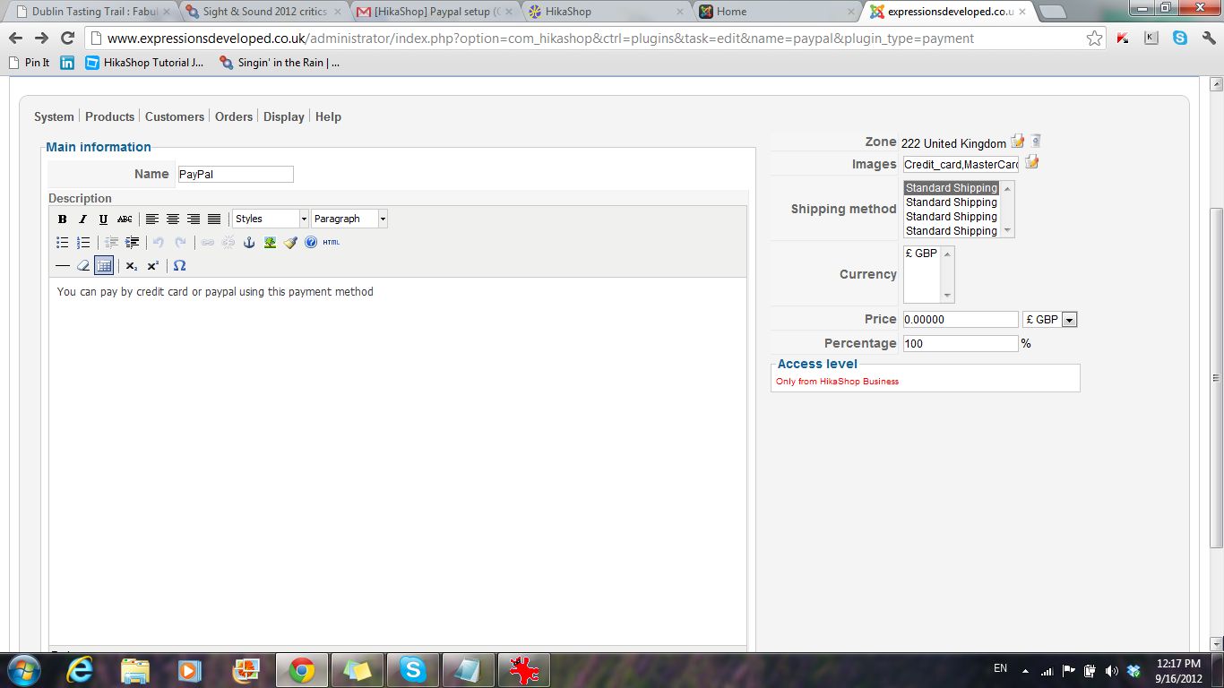

Hi Mohamed, I'm sorry to reply so late to you. I've attached a screen shot of my paypal plugin screen. For some reason, I don't see where I can enter the paypal email. It's also missing other fields. Thank you in advance for your help!
12 years 3 months ago #65673
You're not in the "real" paypal payment method, you should have another payment method name paypal, so use it :)

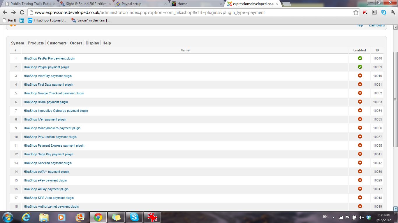

This is very embarassing, but I don't see the "real" paypal payment method in the plugins :blush: ...there's the paypal Pro payment, but that has the same screen (I've attached a screen shot of what I see when I click on the payment methods in configuration).

You should use the PayPal payment plugin on that screen.
On the option screen of the PayPal payment plugin, you should have a lot more options than on your first screenshot.
If you don't, it means that your missing some things.
Maybe the paypal plugin files are not there or something.
You should normally find them in the folder plugins/hikashoppayment/paypal via FTP
I can see that you don't have the latest version. Maybe an update would help to solve that problem...

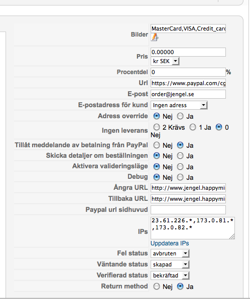

I have used Hikashop for some years now, and it always work as a charm. For some reason though, I can not get paypal standard to work with my new web page. I attach two screens with my settings, one with the generated code on the last page. My problem is that once I push continue to paypal - it searches for paypal and then for some reason ends up with a blank page under my domainname.
I read threads on this subject and tried to disable my template from pixelparadise, I also went in to paypal account and made sure everything was ok with the settings in there. I have tried numerous of settings recommended here: www.hikashop.com/en/support/documentatio...nt-paypal-error.html and one time I had problem with the adress fields, but now I get no return-error message at all.
Could this have to do with that my site is installed on www.jengel.happymindsstudios.com but the DNS to www.jengel.se is set to another host, that is redirected back to www.jengel.happymindsstudios.com . This is a temporary solution, we are just building the site on this sub-catalog.
Thanks for any advice.
The paypal function is disabled atm, I can put it back on for you if you want to.

Can you give us a screenshot of your paypal plugin configuration ?
Have you refreshed the IPs ?
  • Posts: 18
11 years 11 months ago #90175
Sorry, I thought the printscreen was attached in my message above. I see now I attached the wrong file. I edit it now with the present one.

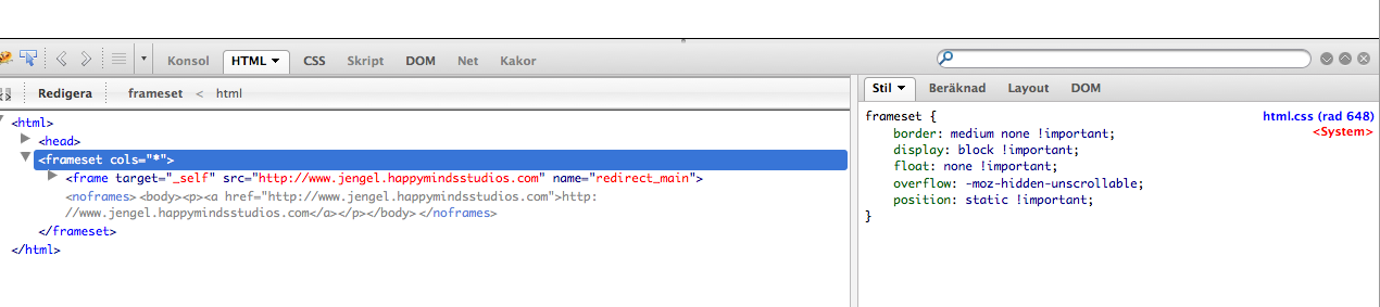

I get the same error-message in code in explorer: This content can not be displayed in a frame...yadi yadi.. try to open this window in a new browser....

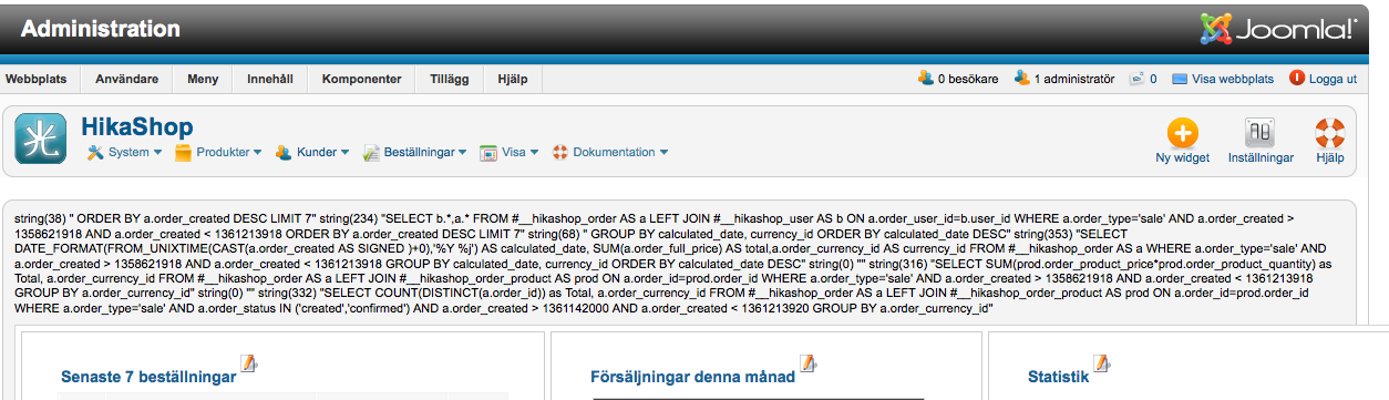

So, fyi, I don't know if this has anything to do with anything, but if I log in and go to the control panel in hikashop, it looks like the screen capture below. And if I go into code in firebug "<div id="iframedoc" class="iframedoc"></div>" are blanked out so to say.

I was using Chrome when I tested and didn't had any redirect issue. There was no iframe on your website so no need to display that error message.
I'm guessing that maybe you're accessing internet via a proxy (maybe your internet provider ?) and it adds an iframe around the website or something ?
Since everything is ok for me on your website, there is nothing to fix as far as I can see. However, if the error message you have says that the problem comes from an iframe issue, the solution should be easy.
Edit the file plugins/hikashoppayment/paypal/paypal_end.php and change the line:
<form id="hikashop_paypal_form" name="hikashop_paypal_form" action="<?php echo $method->payment_params->url;?>" method="post">
to:
<form id="hikashop_paypal_form" name="hikashop_paypal_form" action="<?php echo $method->payment_params->url;?>" method="post" target="_blank">
That way PayPal payment gateway will open on a new page and you should not have iframe issues.
