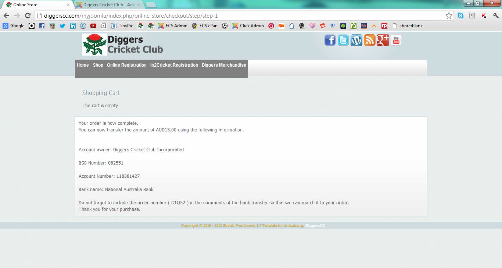

I no longer get the error message but still don't get an email. I get the attached screen after checkout which is correct but no email.

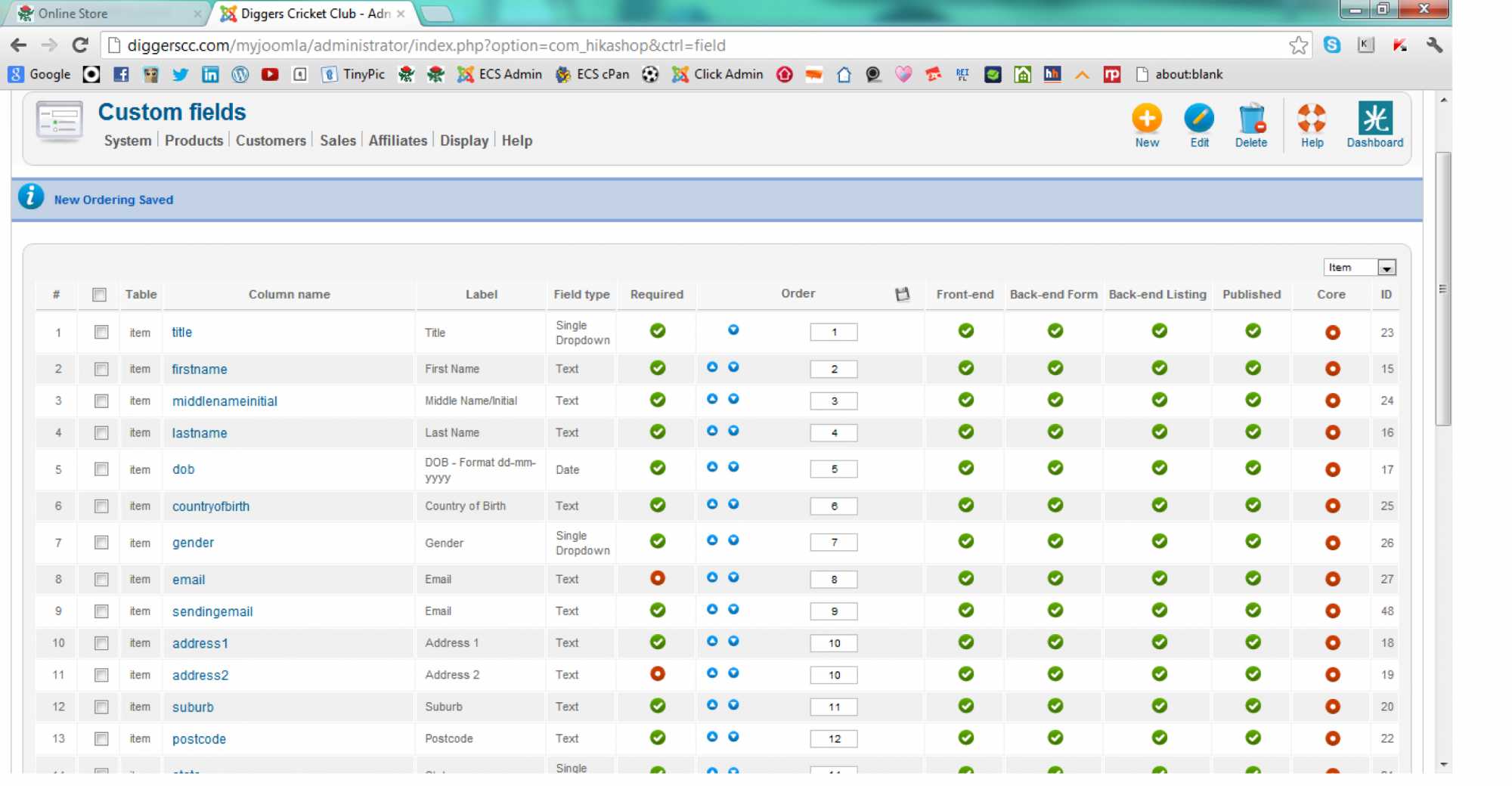

I have now set up a new custom field with the type "item" and column name "sendingemail" and published that. I have also attached a list of my custom fields.
If I unpublish my original email field - type "item" and column name "email" the error returns so I now have 2 email fields showing in the product screen.
