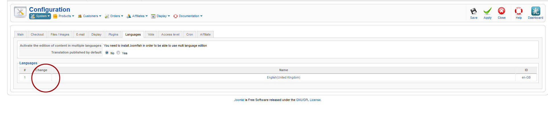

screenshot attached.
The edit language button appears to be missing?

The edit button being missing might come from the fact that the edit image is missing.
It can potentially happen if you have deleted the bluestork template. Is that the case ?
If so, you should put it back and the image should then display.

12 years 7 months ago #66382
It's a Joomla 1.5 site, no bluestork.
  • Posts: 35
12 years 7 months ago #66383
fixed the edit button issue, 1.5 pulls the edit button image from M_images folder. It had been deleted.
