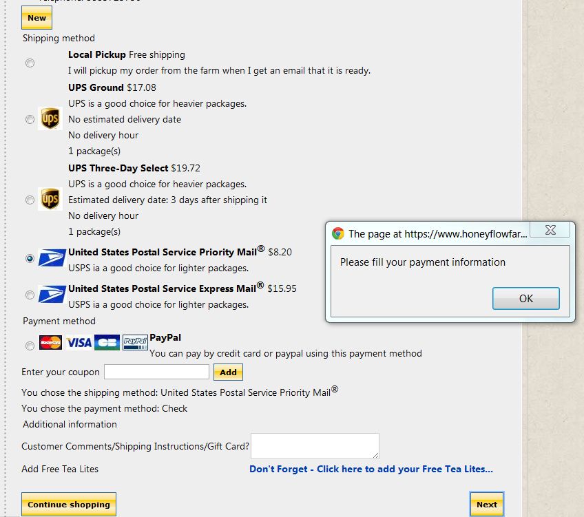

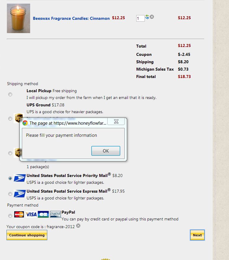

I recently upgraded to Hikashop1.6 and a few strange things happened.
My "Send Check" program is visible and can be selected but will not finish the order - view attached file.
Also, when I add a product to the cart, the small window comes up fine - but stays there (you have to close it yourself). This is not a big problem but it used to automatically close. Is this normal? The program asks to select payment - but it was already done.

12 years 1 month ago #67269
Hi bigfoot,
For the popup delay, the problem has been corrected in the last release, you can download it again from our website and install it.
In your screenshot, I don't see your "send check" program in the payment methods on your screenshot, and the "select payment" popup is displayed because you don't select any payment method.
In your screenshot I see only one payment methode, PayPal.

I just changed my workflow to: cart_login_address,cart_shipping_payment_coupon,cart_status_fields_confirm,end because customers were very confused and had problems with the original default one.
Now, If I check out using a credit card, I can enter the card info but I am forced to go to pay pal. You can see on the image (after entering card info) that paypal & credit card are combined and going forward only goes to payhpal.
