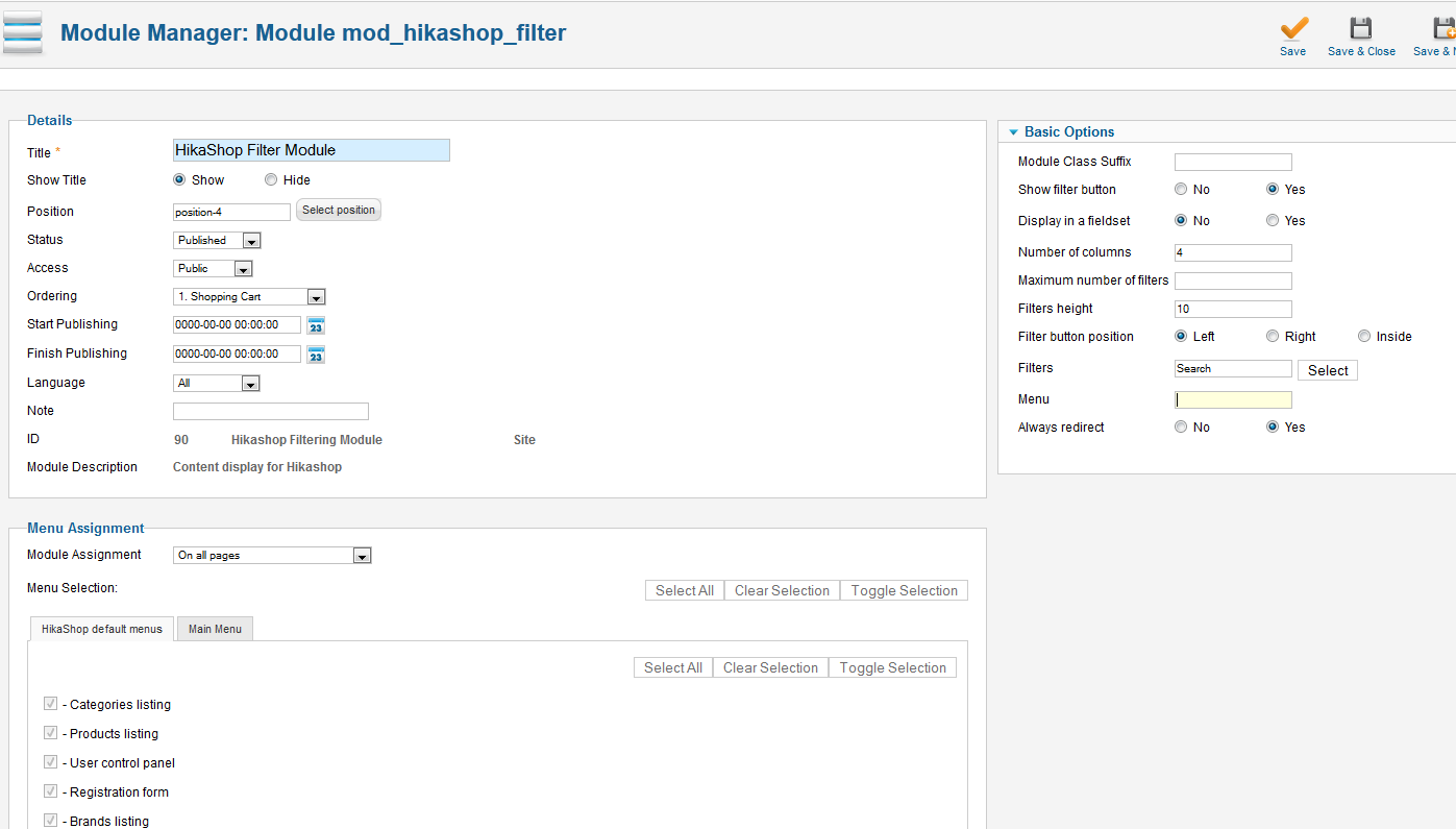

the menu id is what is confusing me ? what is this for? here is a screenshot
  • Posts: 2334
  • Thank you received: 403
12 years 6 months ago #68638
That's it. The field is empty in your case. You have to look at your menu listing (in Hikashop) and select (or create) a menu with all of your products inside and with the layout you want.
Then, Just look at the id of this menu (on the right in the menu listing) and specify this id in the filter configuration.

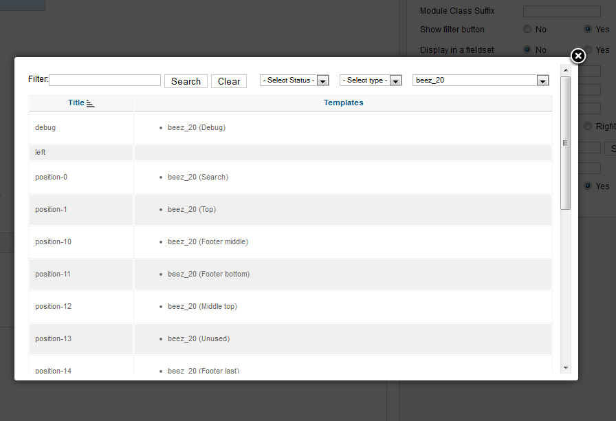

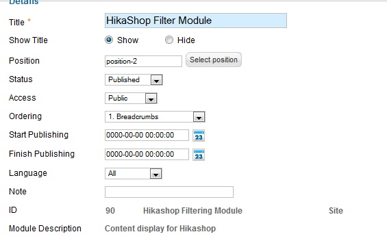

thanks for that i allocated the menu id but now when i try to place the module on a page doesnt appear, ive tried different templates including the default joomla ones and tried various positions but it doesnt appear. I attach a screenshots. In hika3 png the module is supposed to be in postion 4 but as you can see its not there. It is enabled as shown in hika5.png
  • Posts: 83604
  • Thank you received: 13536
12 years 6 months ago #68813
I don't see why it wouldn't display.
In order for it to display you need to :
have filters
make it display on all menus
have it enabled
have it access allow you to see it (public)
have it in a valid position of your template
make sure that caching is disabled on your website
That's all I can think of.

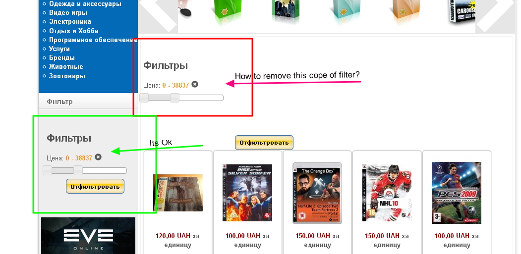

read few topics about filter but dont find or missing answer. my problem when i publish filter it publish in content but i dont need this.I publish module only for one menu but filter show in another places of site. how to remove filter copy from content?

10 years 11 months ago #153797
To remove that you have to disable the option "Display filters" in the menu / module settings.

  • Posts: 540
  • Thank you received: 49
10 years 11 months ago #153819
tnx
its possible change this setting for 80 menus at "one click" ?)
upd. system-config-display-Display filters on product listing-No
Last edit: 10 years 11 months ago by master_b.
10 years 11 months ago #153833
Indeed, the option in your menu / module should be set on "inherit" so changing the value in Configuration > Display > Products > "Display filters on product listing" allow you to change the value at one click.
