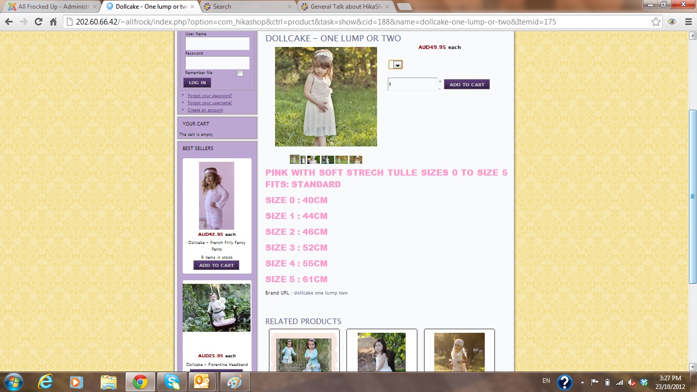

2. My related products are still not showing. I have already tried the instructions below.
How to display your related products below your products:
a. Create a new module of the type "HikaShop content module" via the joomla modules manager and leave it unpublished in the joomla options of the module.
b. In the HikaShop options of the module (there is a link to them on the right of the module's joomla options screen), make sure that the "Type of content" option is set to "product" and that the option "Content on product page" is set to "Related products".
c. In the Display tab of the configuration of HikaShop, click on the "Select" button of the "Modules under the product page" option. Set your related module to published and click on OK. Then, save the configuration.

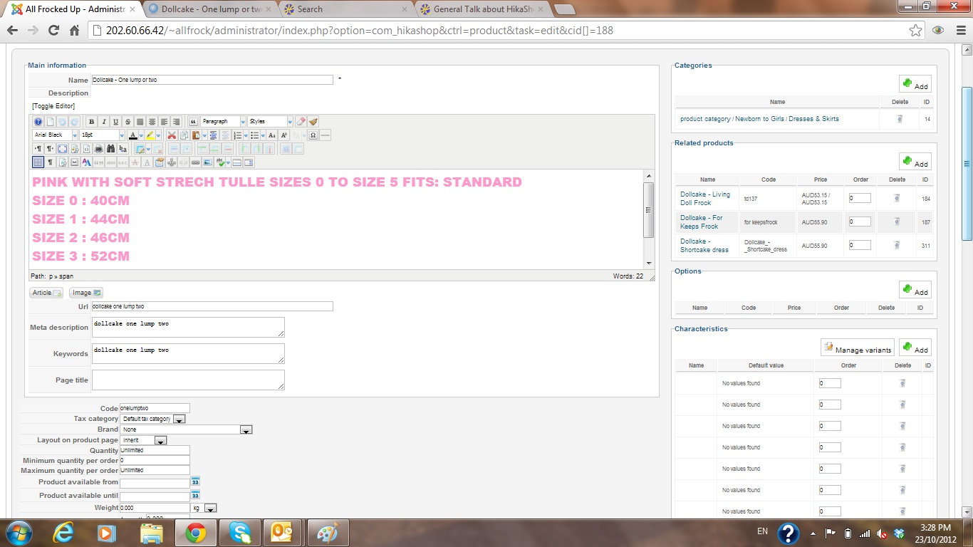

Step 2: re Related Products

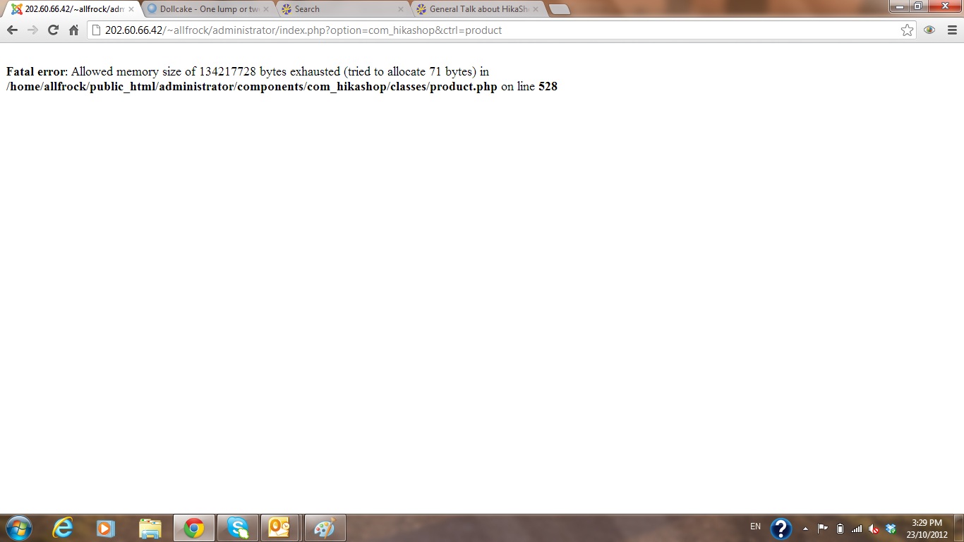

I went through it again, and the related products bit is working fine now. My only issue is that on products linked to related products, the characteristics and variants are not showing correctly anymore with a fatal error when I click on variants. What happened there?
I have attached the screenshots related.
Thanks.
  • Posts: 14
12 years 5 months ago #71557
Sorry I meant to attach the error message too.
  • Posts: 2334
  • Thank you received: 403
12 years 5 months ago #71832
The error seems to come from the generation of variants.
How much characteristic do your product have? If there is too much characteristic, it may cause that kind of issues.
