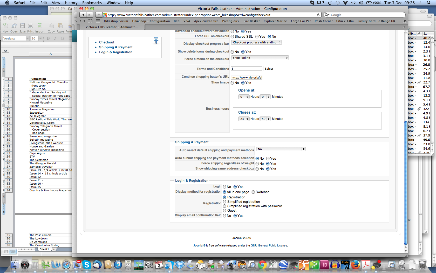

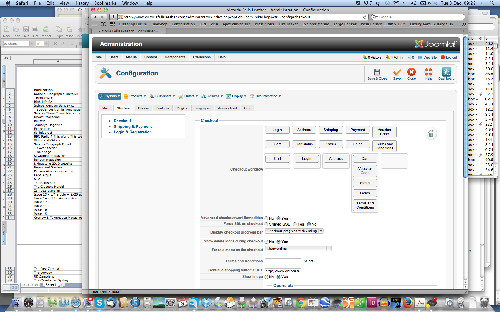

12 years 3 months ago #134763
Can you show me how did your configured your checkout workflow ("Hikashop->System->Configuration->Checkout") through some screenshots ?
  • Posts: 105
12 years 3 months ago #134910
Here are the screen shots of what you asked for. I am going to try reinstalling hikashop and see if that works meanwhile. I am sure I have just done something stupid by mistake.
Kind regards
  • Posts: 105
12 years 3 months ago #134921
I reinstalled Hikashop 2.2.2 and it now works. Obviously, I had done something I shouldn't have.
