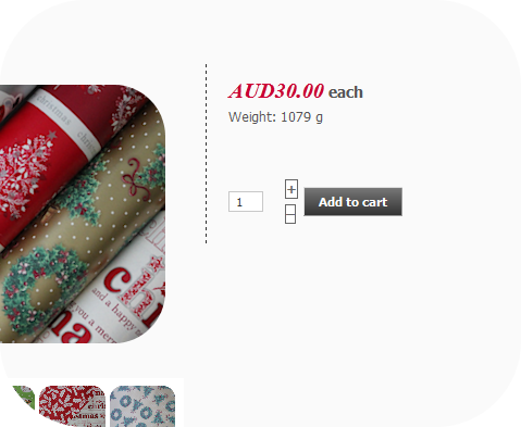

G'Day,
I realize this one is likely easy but darned if I can find it..
On the detailed product page it is displaying WEIGHT.. weight only? (and description at hte bottom how bizarre).
Any way that I can remove weight from this page? I'd also like to add a continue shopping button and I'd like to make that AUD30.00 look like $30(AUD)
THANKS! You guys rock, I have learned so much!
Susan

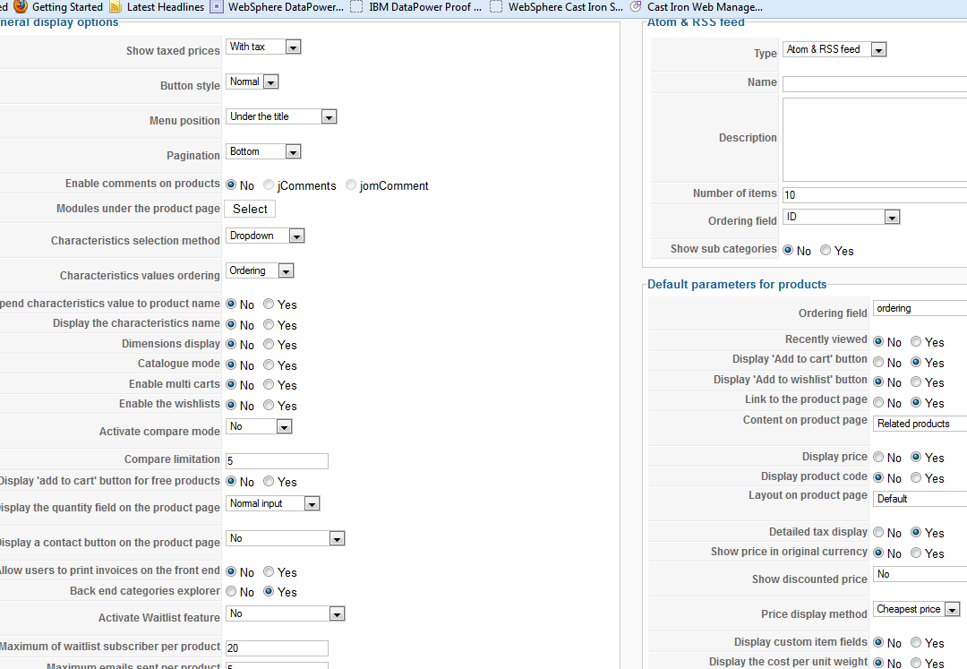

  • Posts: 103
12 years 5 months ago #72259
Hi Eliot (I hope it's Thursday night for you not Friday),
The only weight reference I see on my Display Page is "Display the Cost per weight" and the radio button is set to NO.
I also have some social networking buttons (tweet/facebook etc) magically appearing at the top of the page?!?
THANKS!
  • Posts: 2334
  • Thank you received: 403
12 years 5 months ago #72260
The weight display option is the general option field, if you don't see it maybe you don't have the last Hikashop version so you should update.
About the social network buttons it's plugin you probably activated. You can find it in the joomla's plugin list and disable it :)
  • Posts: 103
12 years 5 months ago #72270
Good One! I had ITPShare installed in Joomla but had it disabled.. but your post made me search again and Hikashop social was published! Shame firebug can't help me find some of these things...
I have the "latest stable version at 1.6.0"?? I attached my screenprint..
