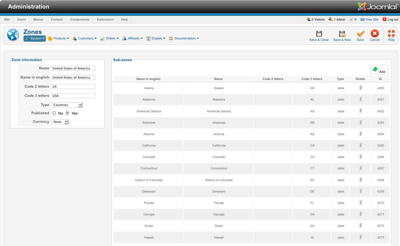

I've attached a screen grab of the USA state zones, which shows the 2-letter codes in the 3-letter column, is that as it should be (this is the default as supplied with HikaShop). If it's not correct, does this mean that the changes I've made to the code won't work? Just curious.

12 years 5 months ago #75333
Yes you're right, can you try this:
		if(@$order->cart->billing_address->address_country->zone_code_3=='USA'){
			$postData['BillingState'] = @$order->cart->billing_address->address_state->zone_code_3;
		if(@$order->cart->shipping_address->address_country->zone_code_3=='USA'){
			$postData['DeliveryState'] = @$order->cart->shipping_address->address_state->zone_code_3;

12 years 5 months ago #75377
We've tested that, and it seems to work fine. Thanks a lot for all your help.
