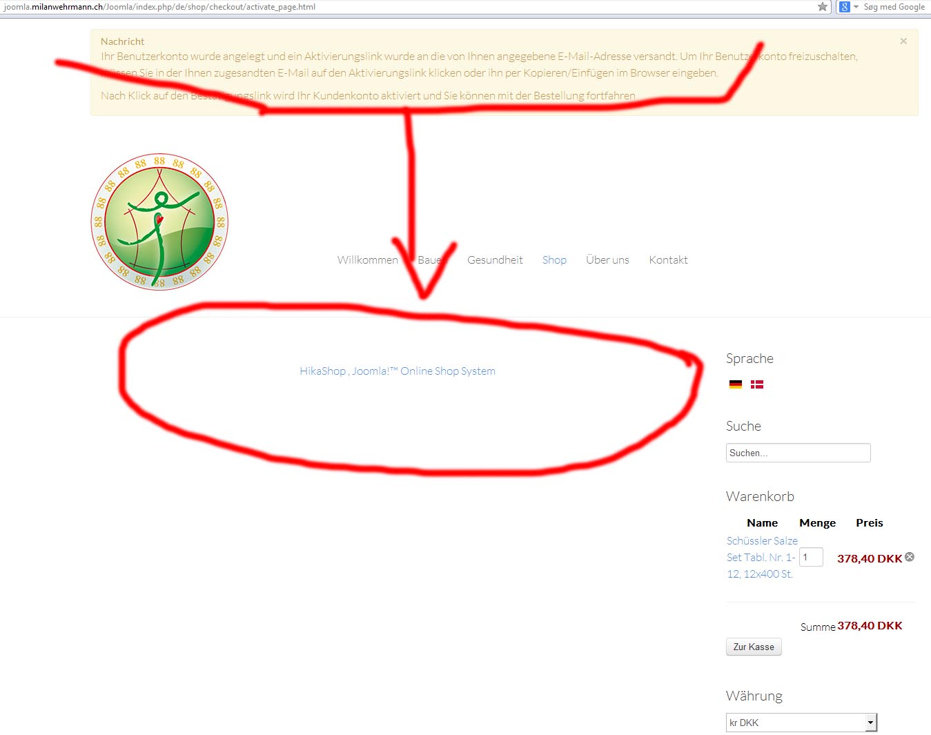

But something others:
If I have indicated in a new visitor every user address data and I click to register, then comes a new site with the message that you have to activate the email-link.
Can I change the place from over my logo to below the logo?
  • Posts: 83605
  • Thank you received: 13538
12 years 5 months ago #75664
The messages are displayed by your template. You will have to edit your template's index.php and move the messages zone below your banner area.
I would recommend to contact your template provider for that as it can be a lot different from one template to another.

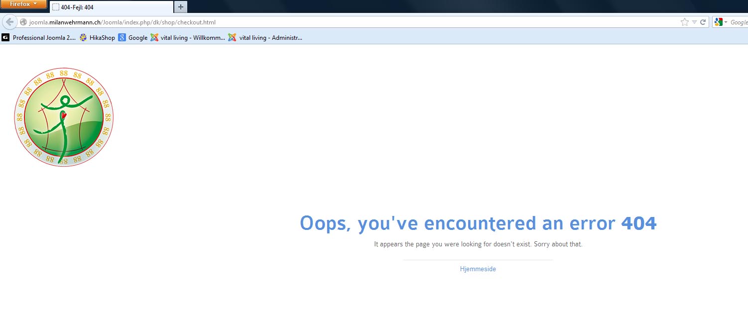

another problem after I click on the activation link in the email.
I recieve a error page 404. Why?
Thank you for your support!!!
  • Posts: 16
12 years 5 months ago #75680
but if I go back to the shop, the activation was made.

12 years 5 months ago #75863
Try to change the line:
$this->registerData->activation_url = HIKASHOP_LIVE.'index.php?option=com_hikashop&ctrl=checkout&task=activate&activation='.$user->get('activation').'&infos='.$vars.'&page='.$page.'&id='.$this->user_id.$url;
to:
$this->registerData->activation_url = HIKASHOP_LIVE.'index.php?option=com_hikashop&ctrl=checkout&task=activate&activation='.$user->get('activation').'&infos='.$vars.'&page='.$page.'&id='.$this->user_id.$url.'&lang='.@$_GET['lang'];
in the file administrator/components/com_hikashop/classes/user.php
Last edit: 12 years 5 months ago by nicolas.
