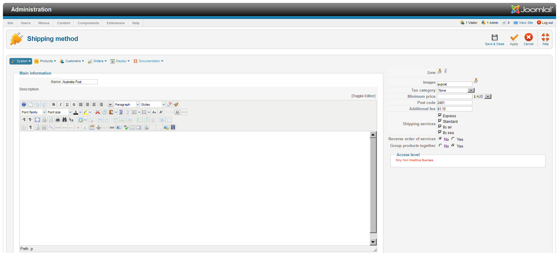

  • Posts: 55
12 years 4 months ago #79418
attached
12 years 4 months ago #79447
Ok so can you set the "zone" option to Australia ?

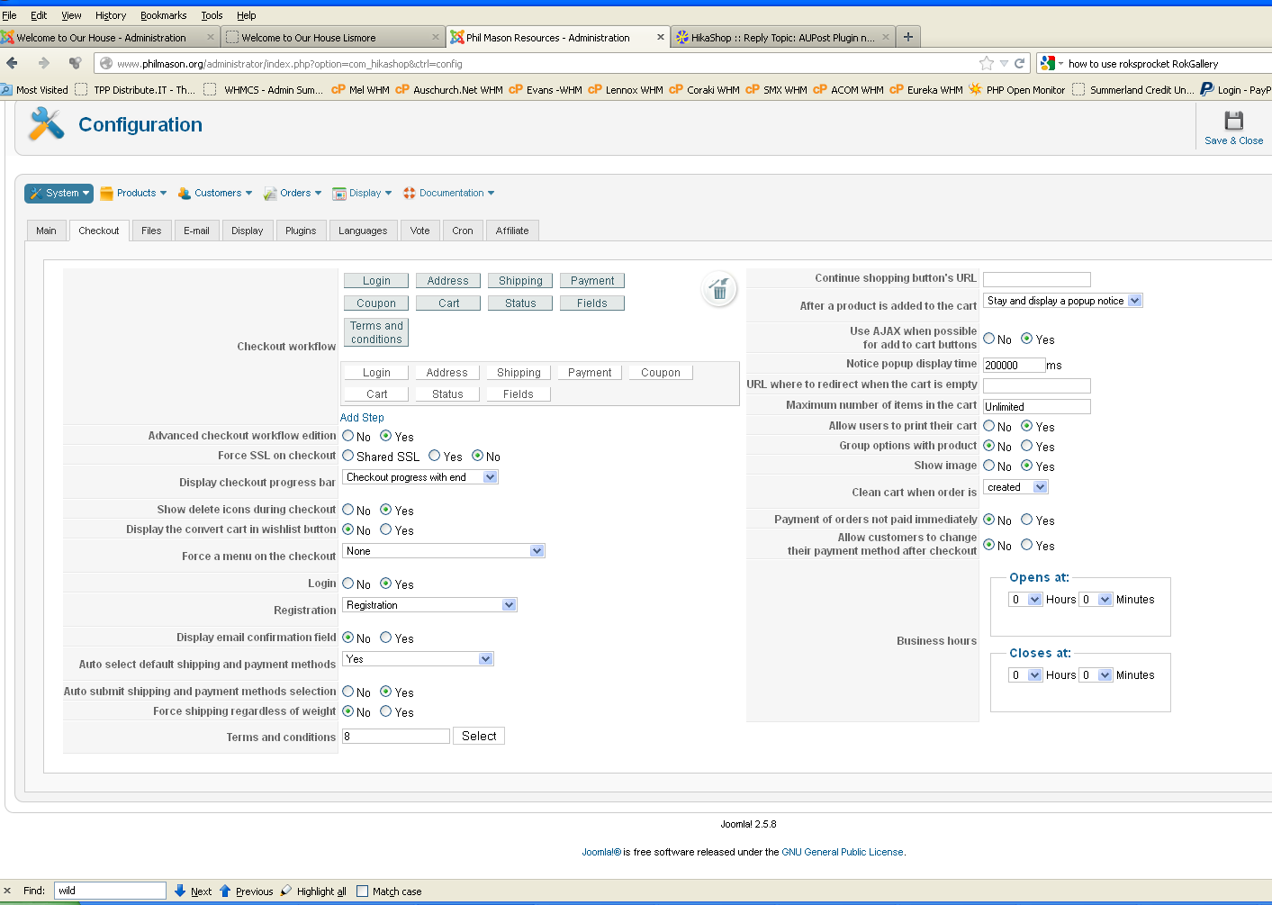

12 years 4 months ago #80665
Hi Ian,
I did some modification on your global configuration, and it seems to be working fine now, but the last problem that you have is that you don't have any error message because of your template. So you'll find the solution there :
HikaShop uses the core Joomla messaging system to display messages on your website so if you don't see any message when you don't enter correct information during the checkout process, that's probably because your Joomla template does not contain the tag to display Joomla messages: <jdoc:include type="message" />

  • Posts: 55
12 years 4 months ago #80774
I would be interested to know what changes have been made to global configuration to make this now work?
- as there was nothing I could see before that would lead to a fix.
The ganrty templating system does not appear to use the normal <jdoc:include..> statements
but I have seen error messages appear in the past on check out issues.
Usually top line of screen rather than in the body of the page.
The checkout still fails checks though; when I create an order and change my billing address to a 'fail' ie instead of postcode 2480, I place an n before it;
This then allows me to proceed to checkout without shipping applied; so my guess is that the chnages that were made to the global config have not improved this issue.
I would be interested if you have experience with system messages in the rockettheme templates though, as obviously they use some other mechanism to show system messages
I would have thought that it couldn;t be connected to a tempalte issue though, as hikashop would have it's own checks and balances against being able to proceed without shipping.
I have changed force shipping on checkout to no; as freight was being levied on mp3 downlaods.
ian
