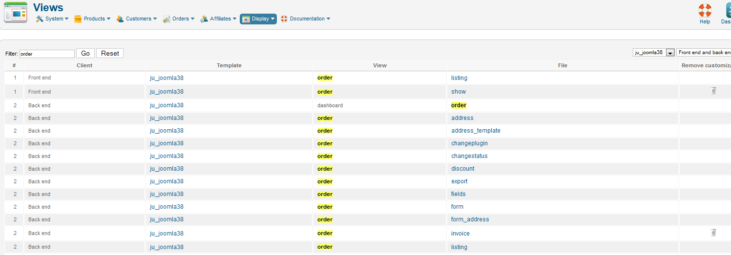

Here is a screen print of what views I customized with the code.. you can see I have it on my ju_joomla template trying it in both order/show and order/invoice.. (did different)..

I don't know for your frontend template but your backend template is "bluestork".

THANK YOU! I started editing after I thought about your hint about the correct template.. I have never edited a display that was "back end" before. Didn't really think it had a different template.
All I can add to this is "DUH"
THANK YOU THANK YOU
