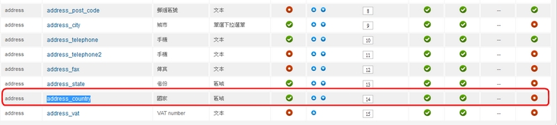

I realized when I switch off the "address_country" in View->Custom Fields/Column of the Hikashop back end,

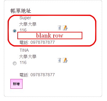

the resulting billing or shipping address format during checkout process will show an additional blank row as seen in the following:
If I switch on the "address_country" again, the blank row will show the country name.
I wonder if there is a solution to make the blank row disappear if I switch off the country column.

Try to edit the view "address / address_template" in HikaShop > Display > Views and remove the line "{address_country}".
