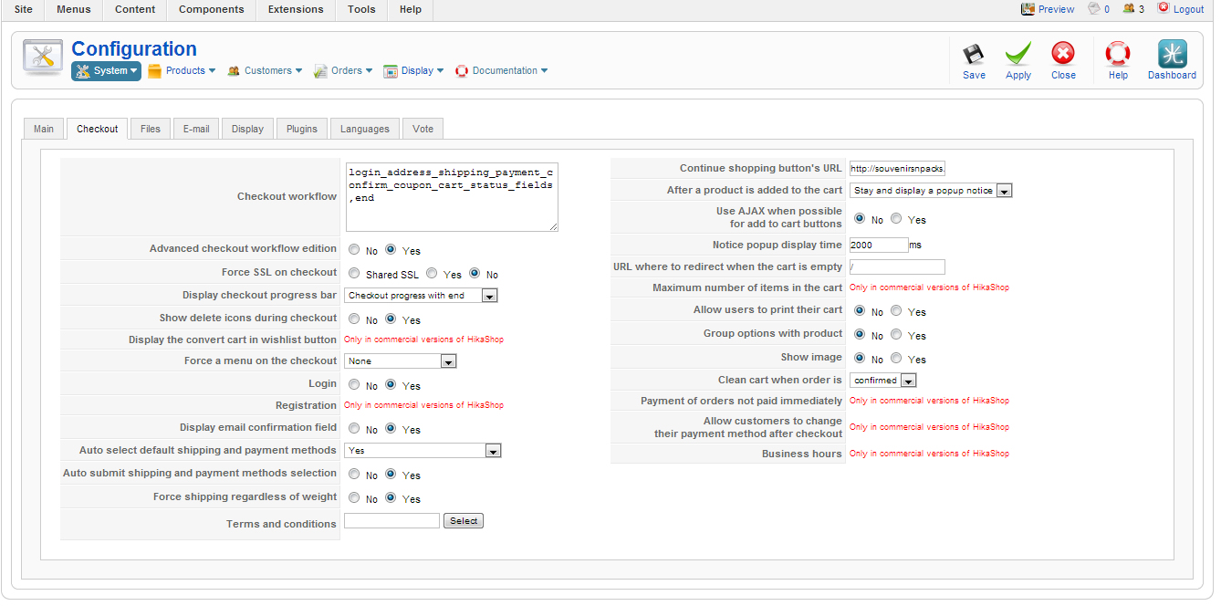

Pls find attached the screenshot of my checkout flow. I've sent you PM for the details of my website.

Sorry pls find attached the screenshot

11 years 11 months ago #80712
It seems that you have a problem with the checkout workflow configuration. You have enabled the advanced checkout wordkflow but the old one is displayed.
Can you check in phMyAdmin on the table "#__hikashop_config" if the value of the field "checkout" is "login_address_shipping_payment_confirm_coupon_cart_status_fields,end".
Are the shipping method and payment method displayed and selected in the step one ?
Have your products a weight ?
  • Posts: 11
11 years 11 months ago #80721
Thank you for the quick response. The value of the checkout in phpmyadmin is the same as above. The shipping method and payment are displayed in step one and my product does not have weight.
