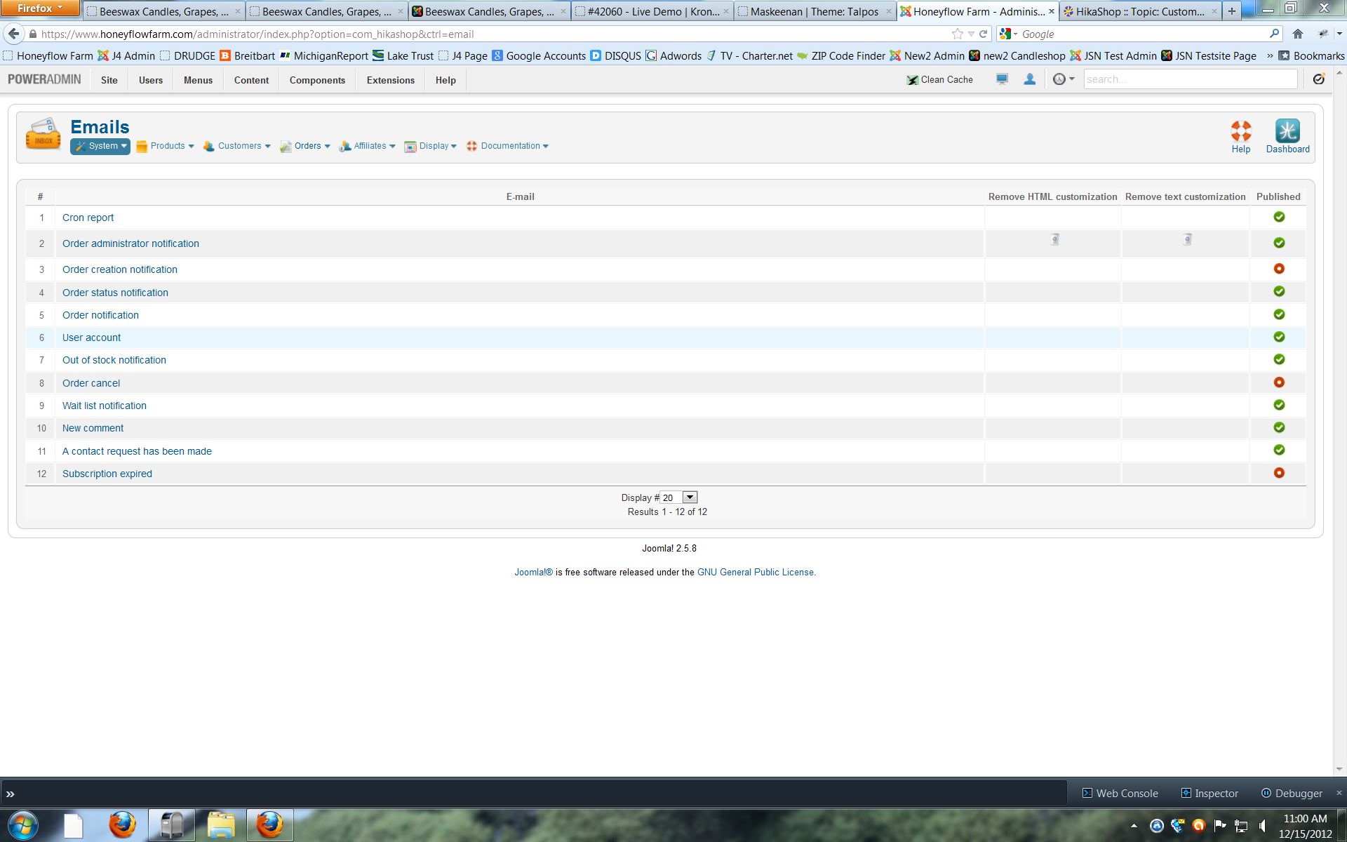

Can you do a screenshot of the System>Emails menu please ?

11 years 11 months ago #82218
Screen shot of system emails

I see that you unpublished the "order creation notification" email. Please publish it and you will receive the creation email after the order is created.
  • Posts: 246
  • Hikashop Business Hikashop Essential
11 years 11 months ago #82403
OK - Thanks - It is working now. There was a reason I unchecked it - but I do not remember. Something to do with getting duplicate emails (& info from one of my posts - or someone else's, but I may have changed my setup since then.
