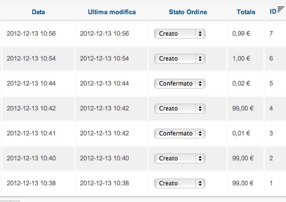

We are testing all the features of Hikashop Basic with the idea to pass to Business Version as soon as possible.
But we are founding an important and strange issue that is blocking us: with a completely new version of the website, everything works properly, but for we are testing two products: one works in all the conditions and the payment is completed, and the other one sometimes works and sometimes not!
It does not pass from created to confirmed status, even if the payment process seems to be the same and complete. It is very strange that sometimes works and sometimes does not.
Here with attached you will find the screenshot of the products. Test 1 works in all condition and test 2 does not.
Any idea?
We saw that wit 0,01 - 0,04 prices it works, but as we move to 100 euro price it stops to work.
Mapi

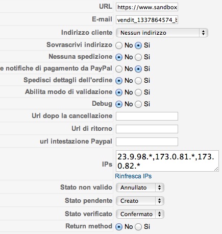

If active debug mode,
no log files written in comes in the payment log file
folder permissions are 777

I also tried to disablethe "Return method" option.
with the same result!

Could you check your database, in the table "hikashop_payment".
You should see just one entry where the "payment_type" is "paypal".
I have just see this problem today in another website and I think that "iDeal" plugin is the source of the problem.
I saw, in the other website, another line where "payment_type" was "PayPal".
So, when the paypal plugin is load for the notification, it found two potential configuration and use the first one, which was the wrong one.
At this moment, you just have to delete the wrong line and paypal would be loaded correctly during the notification (it would found his right configuration).
