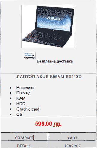

  • Posts: 45
12 years 3 months ago #83962
Happy new year 2013
I have question, it's possible to make such layout in category /see picture for example/
I mean to add a couple buttons in the bottom part to container ?
Regards, Djuni
  • Posts: 83603
  • Thank you received: 13533
12 years 3 months ago #84058
Everything is possible if you code it... You can add your buttons in the file "listing_img_title" via the menu Display->Views.
The following user(s) said Thank You: djundi
