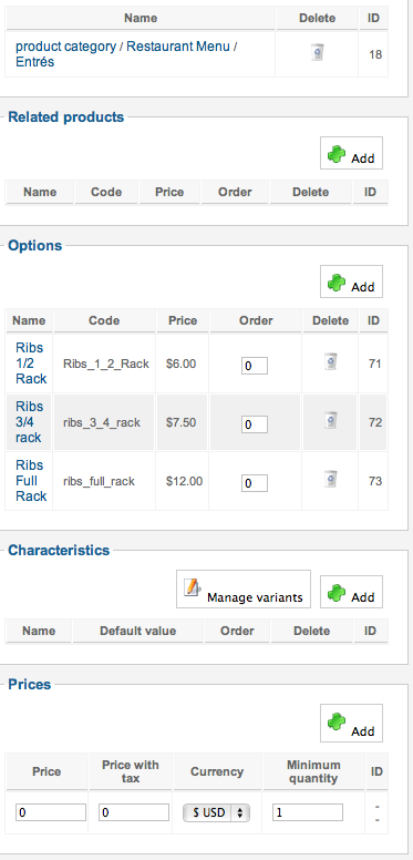

Some of products have prices based upon the size choices made by the customer (see attachment for the backend for this product). But when the product is initially displayed, the price is shown as Free.

- You don't have any product price in your screen shot.
A product option is an option, it means that it is an extra product that you can select, it does not affect the price of the product.
Product option are not variants.
