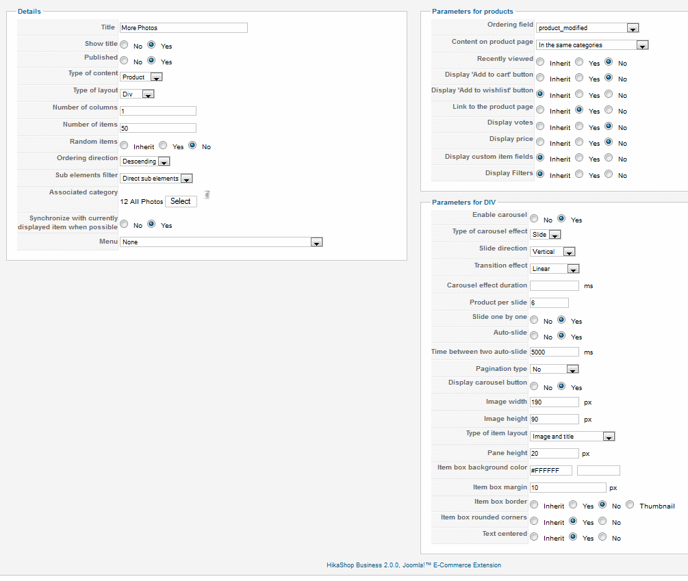

Hi there,
Could you please post a screenshot of your module configuration? I'd like to know what you it to looks like.
Also, about the link, the problem is probably related to the menu linked to this module :)
  • Posts: 164
12 years 3 months ago #84886
More Photos Module settings screenshot attached.
And what do you mean by the "menu linked to this module"?
