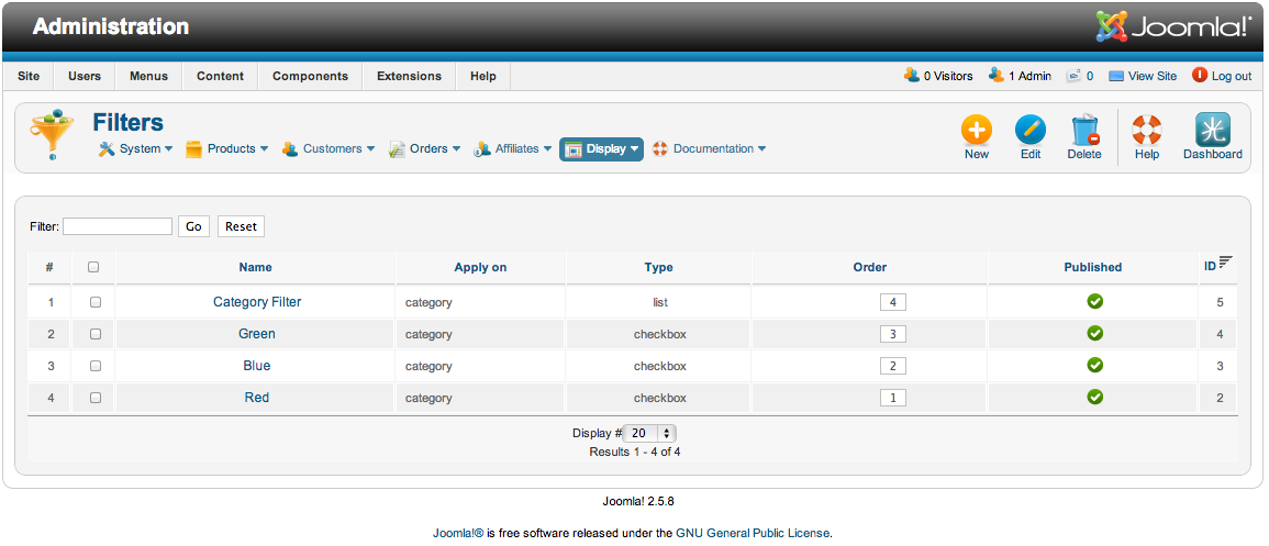

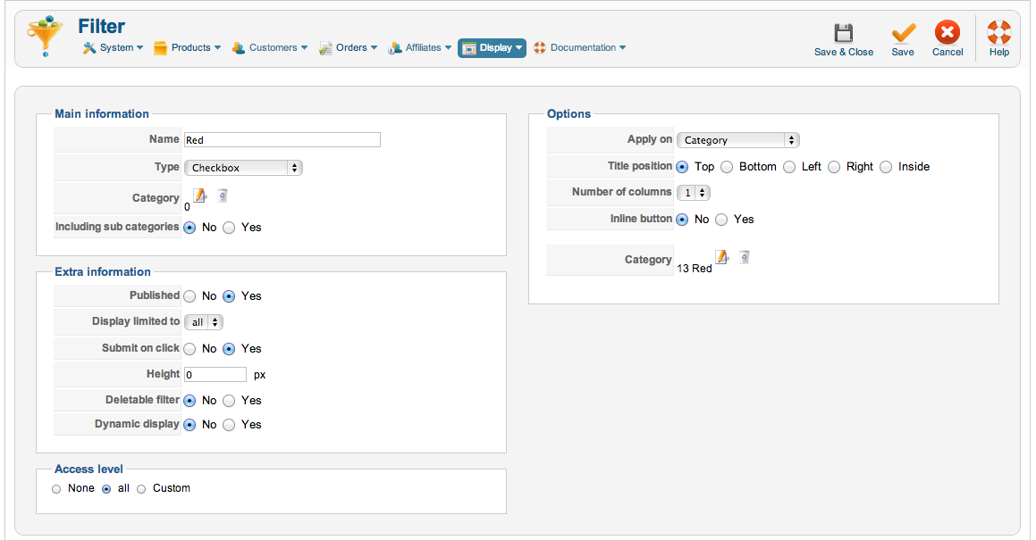

Could you give us screenshots of your filter configuration ?

Are these the screens you need to see?
11 years 10 months ago #86793
You have to select a category for the category option in the filter edition page. You can select the default one "Product Category".

I set a category for each filter. I tried the "Product Category" and others. Still no checkboxes. And the list filter is still displaying categories instead of products.

Hi there,
I think you're not using the right way to get what you want...
I suppose you want your categories (red, blue...) to be displayed with a checkbox beside so people can select one or more category right?
If I'm right, you just have to set ONE filter (like the red one) and select the parent category in the last option ("category").
If I'm right, this filter should display the sub categories with a checkbox non their side :)
