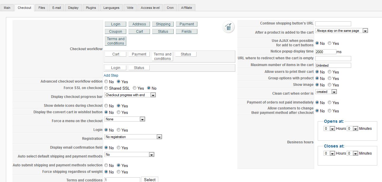

No it dont work, I have tried but it vil not close when I click on OK, and I mean I also have inserted it, but don't get the adress on customer.
This is how the checkout is set.

11 years 9 months ago #88566
Ok, so can you show me how your checkout is when you put the address in the first step ?

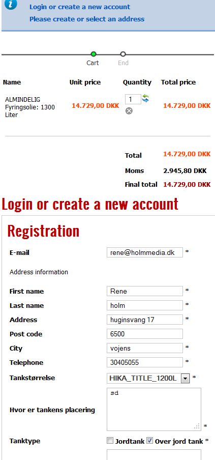

Here is the backend
And how its look like in frontend

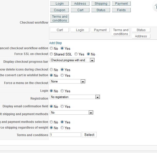

If you don't want them to be registered to your website, I think that this link will probably help you :) :
If you want to have a checkout without registration but with address, you will have to have both "login" and "address" views in the checkout workflow. Then, in the Checkout tab of the configuration, you can change the option "registration" to "no registration" in order to remove the creation of a user account. Also,...

11 years 9 months ago #88596
Its what I have searched for, but it still dosn't work.. The address field is pop up, but I can't close it whit the ok button.

11 years 9 months ago #89373
NO my problem is that I cant go further when i have add'ed extra fields to the address tables. The new fields is showing on the frontpage.
Right now as the site is configured, there you can see what I mean.. I have published the 4 fields and nothing happens when I go to checkout

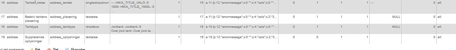

Now I have copied/pasted the fields in the database, and it still not working..
Here is a screen dump from the database, and the fields is in it..

11 years 9 months ago #90052
As I said the problem is that the field was not added to the table of the field. So it's not the field table which has a problem but the address table. It's missing the column of the field.
As the documentation explains, simply add the field with a MySQL query via phpmyadmin and that will automatically solve the error. The query should be:
ALTER TABLE jh2w5_hikashop_address ADD `address_tank` TEXT NULL;
