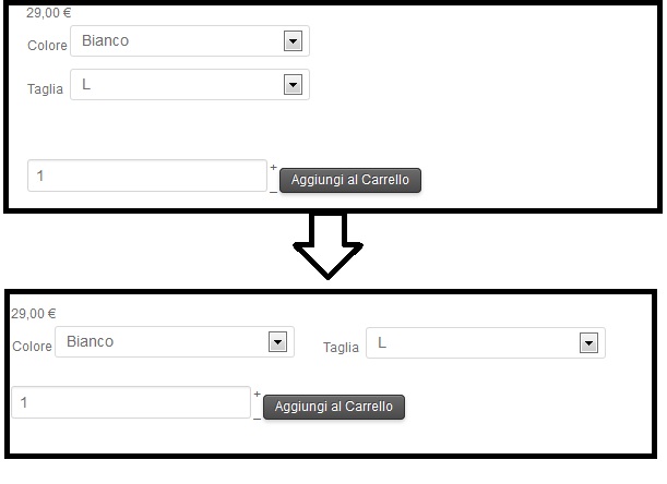

So the layout show_block_charasteristic is
<?php
if (!empty ($this->element->characteristics)) {
?><div id="hikashop_product_characteristics" class="hikashop_product_characteristics"><?php
  echo $this->characteristic->displayFE($this->element, $this->params);
?></div><?php
Where I have to change the layout for caracteristic block?
I mean, in this link goo.gl/DmgtF I need the form "Taglia" just next to "Colore" on the same line.
Thank you

You have to edit "administrator/components/com_hikashop/types/characteristic.php" and edit the format of the case "dropdown".
Be careful it's HikaShop core file, so it's better to copy the original file, and at each update of HikaShop you will have to do these modifications.

Instead of changing the code directly in that file, you can use a characteristic display override whereby you basically copy the code displaying the characteristics in an external PHP function where you can change it and which won't be overwritten each time you update.
It's a bit more difficult than changing directly the code in the file though. Here is more information on such overrides:
www.hikashop.com/en/support/documentatio...tation.html#override
However, I don't think that you need to edit any code to do that change. You shoule be able to change the positioning of the characteristics simply with CSS...
For that, you need to set a display:block on the tbody tag, and a display: block;float:left; on the tr tags of the tbody of the characteristic table.
The following user(s) said Thank You: davideventurini
  • Posts: 84
13 years 7 months ago #90633
Thank you so much, I did your suggestion with success, thank you again.
